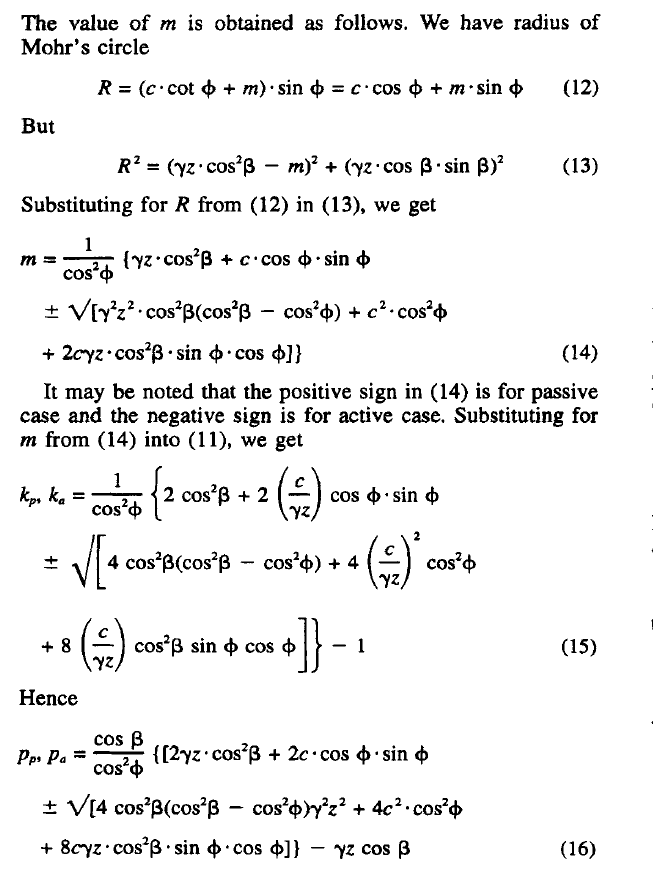

i want to solve below problem
m, ka, pa
i try to solve this problem
but i can't get result.
20230614_lateral earth pressure.sm (100,47 КиБ) скачан 1347 раз(а).
Thanks in advance
#2 Опубликовано: 14.06.2023 22:48:20
Hi. Maybe the attached helps, but's hard to know. At the eqn 16 I count two open [ and only one closed ].
20230614_lateral earth pressure.sm (74,8 КиБ) скачан 1350 раз(а).
#3 Опубликовано: 15.06.2023 07:35:16
StvMath
StvMath
44 сообщений из 71 понравились и 1 не понравились пользователям.
My suggested solution is in the attached.
LateralEarthPressure.sm (9,05 КиБ) скачан 1276 раз(а).
#4 Опубликовано: 15.06.2023 10:55:05
Get more accurate solutions from roots(,,,)
LateralEarthPressure.sm (13,13 КиБ) скачан 1309 раз(а).
#5 Опубликовано: 15.06.2023 23:28:49
Hi. Another way, plugin-less version. Have the advantage that can recognize the active and passive cases.
Click to enlarge
20230614_lateral earth pressure polyroots.sm (77,28 КиБ) скачан 1302 раз(а).
