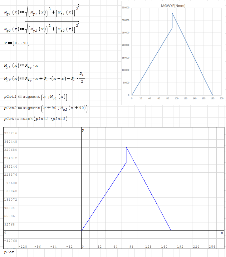

I was stuck in a ragged moment. I don't know how to draw a graph. Finally, a correct chart made in Excel.

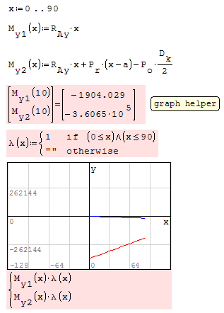

You didn't define a, P, P.o, P.r, D.k.
After them defined with a number, a graph can appear.

Sorry I didn't save before posting.
That's right now.
I have problems with ]the Mg1 (x) and Mg2 (x) graph, this one at the end.
proba do wyslania.sm (50,09 КиБ) скачан 1267 раз(а).
#4 Опубликовано: 09.09.2022 14:07:58
All graphs plotted ...
proba do wyslania.sm (55,25 КиБ) скачан 1236 раз(а).

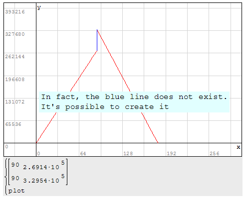

#5 Опубликовано: 10.09.2022 09:19:39
If I understood correctly, you are trying to plot graph picture in your file.
Here it is, you can download and check it from file below.
proba do wyslania.sm (46,79 КиБ) скачан 1237 раз(а).

... for convenience: cumulative integration added.
proba do wyslania (1).sm (59,29 КиБ) скачан 1233 раз(а).

Actually you don't need stack, augment, vectorize, etc.
It can also be plotted easily like this.
proba do wyslania.sm (45,61 КиБ) скачан 1233 раз(а).
