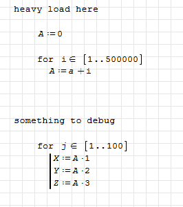

#3 Опубликовано: 18.08.2018 05:09:33
As for now I think the only way it's to insert a dummy operation in the point you want the debug starts (f.e. you can define test:1 and everything will be recalculated from that point onwards)
#4 Опубликовано: 19.08.2018 19:15:29
WroteAs for now I think the only way it's to insert a dummy operation in the point you want the debug starts (f.e. you can define test:1 and everything will be recalculated from that point onwards)
More simply: copy/paste on new page what belongs to debugging,
or disable all stuff that does not belong to debugging.
Modular programs are easier to debug piece wise.

#6 Опубликовано: 07.09.2018 20:59:38
Step 1 is to evaluate the whole worksheet
![2018-09-08 01_54_17-SMath Studio - [Page3_].png](/ru-RU/file/PCq3hR/2018-09-08-01_54_17-SMath-Studio---_Page3___png)
Step 2 is to set the breakpoint
![2018-09-08 01_54_33-SMath Studio - [Page3_].png](/ru-RU/file/qgqKTM/2018-09-08-01_54_33-SMath-Studio---_Page3___png)
Step 3 is to trigger the evaluation of the block, by defining something before that block
![2018-09-08 01_56_04-SMath Studio - [Page3_].png](/ru-RU/file/ReAyar/2018-09-08-01_56_04-SMath-Studio---_Page3___png)
Once you find something wrong, edit it and set the breakpoint, then define again something before the block
![2018-09-08 01_56_42-SMath Studio - [Page3_].png](/ru-RU/file/rFWd2e/2018-09-08-01_56_42-SMath-Studio---_Page3___png)
(and repeat... anything above the yellow variables is kept from the first evaluation)
