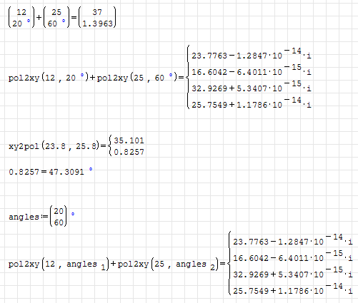

#7 Опубликовано: 21.09.2013 08:10:45
Note that SMath does not return the correct result.
Lists and list operations are not a good representation for vectors and vector operations. If lists obtained by pol2xy are to be added, they must be converted to vectors using sys2mat().
#8 Опубликовано: 21.09.2013 08:38:27
kilele
kilele
@ioan92
Nice explanation on how to get a result. The point of the original question, I think, was a direct way using only polar notation provided by SMath
@mkraska
I forgot to apply sys2mat to an expression involving more than one system, anyway the result of that sum is incorrect.
ioan92 21.09.2013 08:57:00
