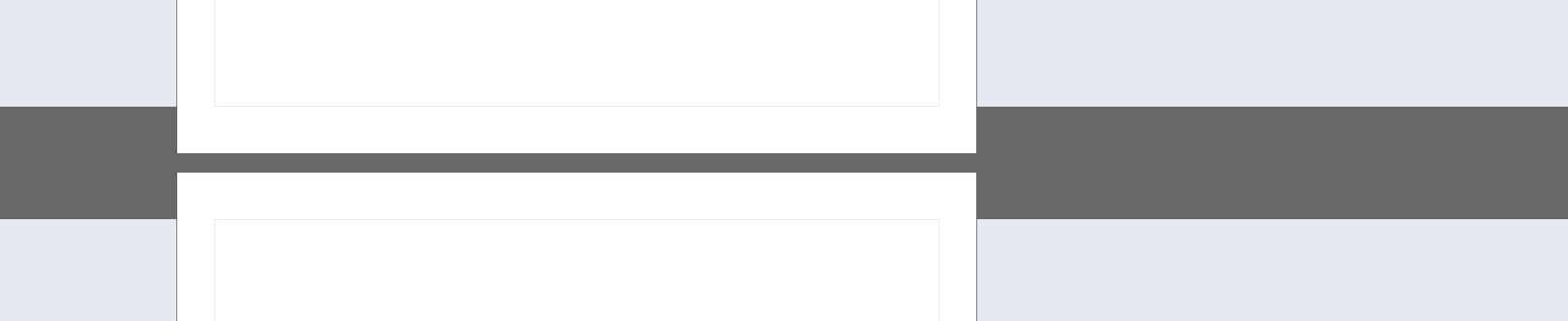

Maybe we should make the background out of the bounds different where stuff can't be placed, like in the image below, so it will be easier to spot when something hits the bottom marggin in the RHS zone.
I'm pretty sure it is more convenient to make it impossible to put regions outside of the page (in Pages layout).

I know it's a challenge to implement, but I think the ability to put stuff in the RHS is really important for annotations, documentation, secondary sanity checks, ideas, etc... Anything that should not be seen on printed or exported files, like what it is possible to do in excel or ppt. At least it's how usually I arrange my documents.
In practice LHS content should drive the pagination, RHS regions should bruteforce split crossing regions and continue in the next page RHS.
As side note, to improve the LHS pagination, as you suggested some time ago, being able to set a grid of break points in the regions would be nice too (but this no matter of the thread 🙂)

Because y-coordinates and worksheet editing. Imagine two regions in the lhs, one at the bottom of page #1 and the other at the top of page #2, let's call it initial state. If I move everything down, they will be stacked on the second page, as expected.
Now in the initial state add two comments on the RHS, same vertical size of the lhs regions, move everything down to the second page, everything works.
Let's say the comment of the first region has a bigger height that fits in the dark gray zone of my picture above; in the initial state there isn't problem, but if you move down the regions to the second page, the second comment will be hidden by the first. For the same reason you cannot create regions in that space (this zone in the end is the dashed line between the pages in printing bounds view, an imaginary range of coordinates between the bottom edge of the first page/region and the top edge of the second page/region, where should they be moved respect to the others when vertical space is added or removed above them?).
In the end having stuff drawn in that area and then editing the worksheet what you'll experience on the RHS vertical spaces appearing or overlaps, and that zone where regions cannot have origin but has no clear gui; that's why my suggestion to grey out that zone.
One might want the rhs like a continuous blackboard, but in that case the cost is to lose the RHS/LHS vertical link; it's ok on a locked LHS layout, but once you start moving things around, becomes a problem.
