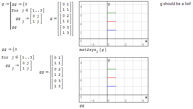

hello again.
How can I get a graph from a variable? Example in graph 2 where nothing appears.
the content of the variable is pasted directly into graph 1 and
there it is working
I generate the matrices to draw a series of rectangles
but I don't know in advance how many rectangles will be drawn
that's why I require to use a variable that contains a system of several matrices
is there another solution?

There might be other issues, but one of them could be the bug demonstrated here. Normally, no element assignment should alter the object type from list to matrix as it seems to happen in the line block definition. I think this is another regression, such stuff used to work in older versions (here 7251).
The original desparate workaround with str2num tries to handle the bug. Normally you should be able to reliably initialize a variable using any object of appropriate type.

#3 Опубликовано: 14.06.2020 19:48:13
Transit the 'gg' matrices via file, plot.
stack-of-rec.sm (31,93 КиБ) скачан 1142 раз(а).

Much simpler Amigo ...
Isolate 'gg' gg:= gg ...or rectangles:= gg
The issue demonstrated in the above post nails down to unexpected handling of single element lists used to initialize the data under numeric optimization.
lists2.sm (6,44 КиБ) скачан 1124 раз(а).
