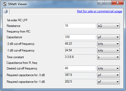

It's possible to make two converters, like this, one that calculates A from B and one that calculates B from A:
But is there any way to make a converter where changing any input updates the other inputs? So there's only one instance of A and one instance of B, and changing either of them updates the other? It would behave similarly to this:

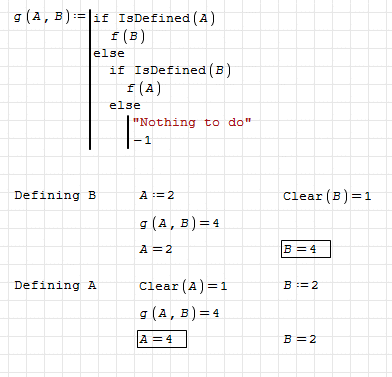

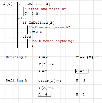

Hi. Something like this?
or
AfromB_or_BfromA.sm (13,01 КиБ) скачан 1107 раз(а).
sergio 30.10.2018 15:43:00

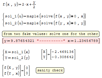

#3 Опубликовано: 30.10.2018 19:39:06
Maybe like this as demo.
If you have an equation of one variable and several parameters,
the solution would be much different, still via maple(root0.
