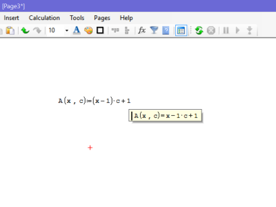

When the cursor is over an equation, it shows the long version of it. However, the tooltip equation (with the yellow background) misses often brackets, which makes the equation wrong. See attached:tooltipproblem.png

http://en.smath.info/forum/yaf_postst7437_Tooltip-doesn-t-show-brackets-properly.aspx

Thank you! Will fix it asap.
#4 Опубликовано: 22.08.2016 12:47:19
2271 сообщений из 3734 понравились пользователям.
Fixed. Will not be an issue anymore in the next SMath Studio release.

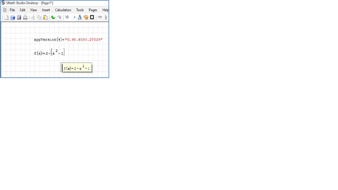

Tool tips problem.
Tooltip.pngTool tips problem

Fixed: http://en.smath.info/forum/yaf_postst7719_SMath-Studio-0-98-6081--25-August-2016.aspx

Thank you Andrey!
It works fine
