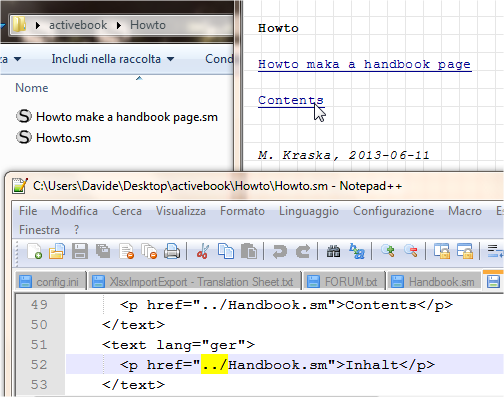

Handbook updated (file in first post exchanged)
- Added page "Howto add linked handbook pages"
- Added templates for handbook pages
- minor corrections and added function descriptions.

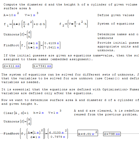

I cannot reproduce the solver problem in the screencast. The default precision is 4 decimal places, whatever that means: 4 significant digits (would be the preferred and only unit-independent variant) or an epsilon setting of 10^-4.

About the FindRoot() in your example. I do not know why I get different result (Win7 64bit), but I messed up with different Nonlinear Solvers by Davide (some of them were totally unofficial). I think we should not worry about this at the moment. We will see when Davide announce the official version.

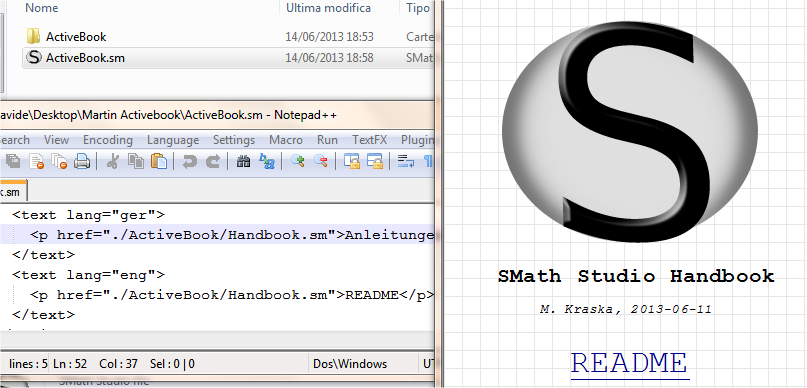

One minor observation. I still do not understand why I should use CTRL+click for using the links, while in the Reference Book just simple mouse click will do the thing. Keeping the finger on CTRL button while browsing the files and contents is not quite appealing.
That is because all files are in "editible" mode for now. You can't edit links, if clicking them jumps to the target. Andrey has added that upon request by me. You can reset that in the file properties dialog. Before that change, you also had to change the visible text in the editor, it was extremly tedious and error-prone. If Andrey some day includes the handbook in the official distribution, then best would be to reset automatically all involved files to non-editible.
I guess that the handbook can easily be hooked into the reference book by adding an appropriate link into the contents page of the reference book. But I shall do structural changes (nested directories and the like) only after efficient link target editing is available. For now, the need to find the handbook root is mitigated by all pages having the back link included.
That is because all files are in "editible" mode for now. You can't edit links, if clicking them jumps to the target. Andrey has added that upon request by me. You can reset that in the file properties dialog. Before that change, you also had to change the visible text in the editor, it was extremly tedious and error-prone. If Andrey some day includes the handbook in the official distribution, then best would be to reset automatically all involved files to non-editable.
As soon as I posted this, I remembered that the files from the Reference Book are not editable. I asked that Andrey long time ago, he explained and I forgot - as usual. I also understand your point now. Thank you.
Strange, this is not happening on my Win7 32bit
WroteFor now, the need to find the handbook root is mitigated by all pages having the back link included.
You're right
BTW a 3rd way could be to add all the worksheets inside a folder and to add an additional "cover" worksheet outside this folder with a link to the HandBook.sm; this not require many efforts and help to have a clear front-end.

I've seen now your video, I do not understand from where the initial results come...
