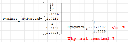

I noticed something terribly grave while working the main sheet.
Explain: while working, Some "illegal" code [apparently], Smath toke
... very happy working well. Bad luck, on closing the work sheet
it zapped the entire work [turn it all blank at reopening]. Oh ! Hell
Good think, most of it I could recuperate from previous attached.
Any fellow experienced such a nightmare ?

ioan92 21.12.2015 18:56:00
Nice work, as usual
Unfortunately, this happens...
I've made this proposal, anyone who want to support/improve it, you have to register in the Bug Tracker System.
BTW seems you have found something that I have to change...
![2015-12-22 00_30_50-SMath Studio Desktop - [Utilities%20Matrix%20Treasury.sm_].png](/ru-RU/files/Download/2gEY8v/2015-12-22-00_30_50-SMath-Studio-Desktop---[Utilities%20Matrix%20Treasury.sm_].png)
Wrotevery happy working well. Bad luck, on closing the work sheet
Thanks Davide for visiting and commenting. The "Why not nested" is simply because on closing,
either XP or Smath don't save the work sheet settings, completely.
I know about Autocad "AutoSave" but don't use AutoCad.
In my case, I didn't try XP Restore because of the time inprecision: it might have done nothing !
On delicate work sheets like "Matrix Treasury" I also save as copy,,, that one was scrapped too !
Your "AutoSave" proposal [link above] is quite welcome. Now convince Smath Developpers.
