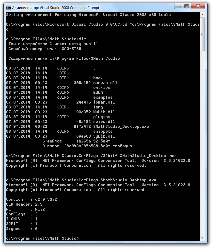

You might try the unofficial portable version (see my signature), it is updated to SMath 0.97. There, the steamtables are installed and ready to use (at least on my system this works).
Thanks to uni for the 32bit-compatible SMath-executable.

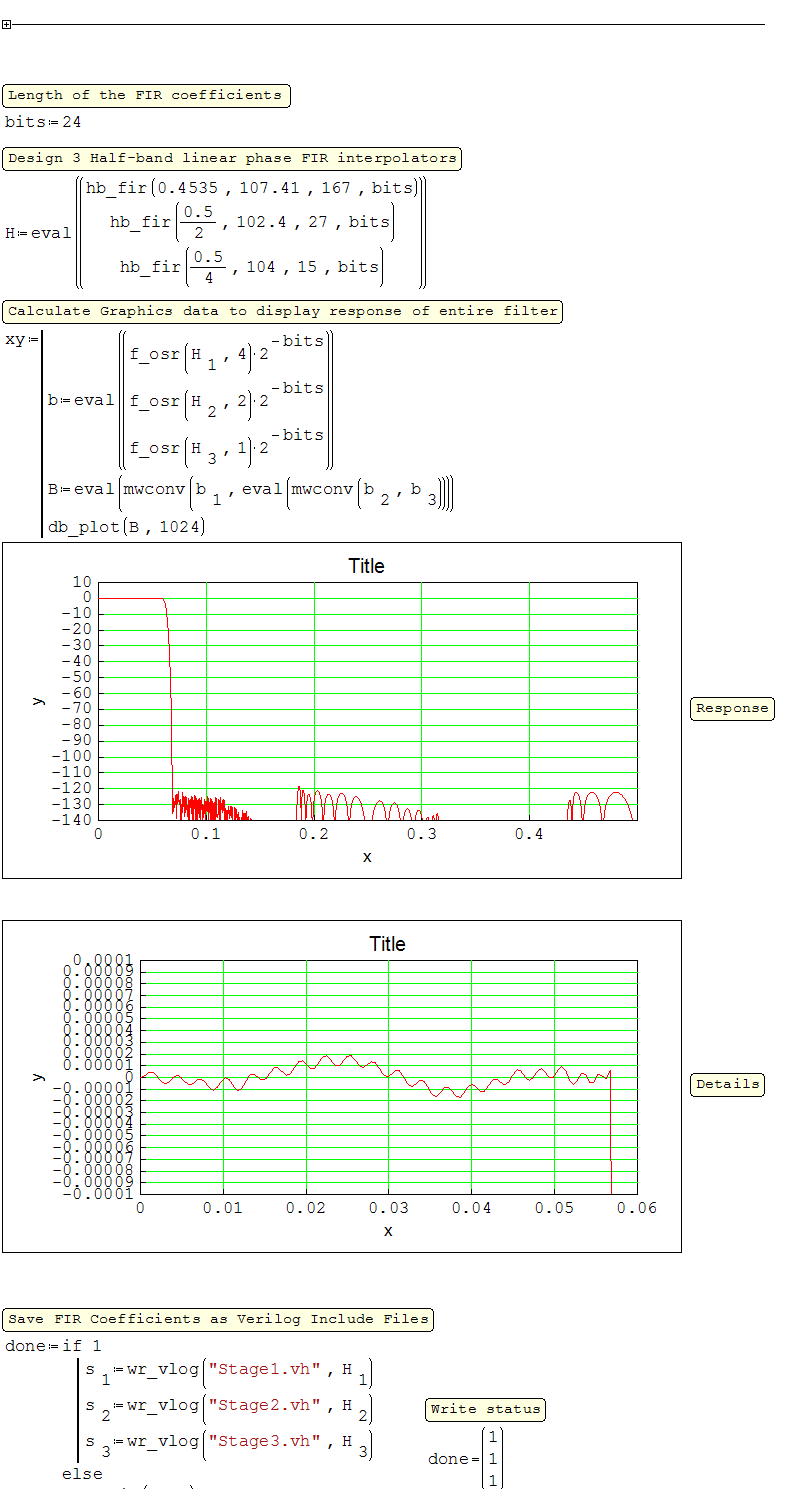

This is my remez2.dll. Usually it works a little better than Matlab tools.
You can design FIR band-pass/stop filters up to length~2000.
The example is audiophile's "holy" NPC SM5842 8X interpolating digital filter.
Before starting the program, do not forget to put remez2.dll in the plugin's \userefi folder.
Вячеслав Мезенцев 13.03.2014 14:33:00
SMathStudio_Desktop_0.97.5189_32bit
How to get this 32-bit version (MSVS2010):
CorFlags /32bit+ SMathStudio_Desktop.exe
Radovan Omorjan 21.06.2014 10:50:00
I'm not a programmer, so VS2010 is not a good option. Simple patch is preferable
So far the flags bits are at the same location for all SMath versions.
Just use HEX editor to write one byte 0x03 to absolute address 0x00000218 in the SMathStudio_Desktop.exe.
Good luck !!
Good luck !!

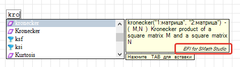

I am the author of the Prode Physical Properties dll for Mathcad and I am excited to see that it is supposed to work with this extension in SMath. However, I can't seem to get the MathcadEFI installed properly. For example, the digamma function doesn't appear in SMath.
I have a path of C:\Program Files (x86)\SMath Studio\plugins. In the plugins folder is mcaduser.dll, mcadefi.ddl, and userefi folder. The userefi folder contains 4 dlls including mathlib.dll.
From a SMath worksheet, tools>plugins shows that the EFI for SMath Studio is present and enabled, although I had to add to files manually as described above.
Can you help?
Can you help?
Mathcad works only with 32-bit plugins but SMath Studio is 64-bit application, so you need to make it 32-bit using CorFlags with administrative privileges.
It is better to use the standard installation method for the plugin.
When the program is running, the mcadefi.log file (located next to the mcadefi.dll) will show the number of loaded functions:

Step 0. Copy CorFlags.exe to the program folder.
Step 1. Start command console with administrative privileges.
Step 2. Move to the program directory:
Step 3. Set the 32-bit flag to 1 (don't forget about spaces):
Step 4. Check the flag value (32BITREQ must be 1):
Result:
Command to return back 32-bit flag value (32BITREQ must be 0):
cd "c:\Program Files (x86)\SMath Studio"
CorFlags.exe /32bit+ SMathStudio_Desktop.exe
CorFlags.exe SMathStudio_Desktop.exe
Result:
Version : v2.0.50727
CLR Header: 2.5
PE : PE32
CorFlags : 0x3
ILONLY : 1
32BITREQ : 1
32BITPREF : 0
Signed : 0
CorFlags.exe /32bit- SMathStudio_Desktop.exe

Thank you for the clear instructions. I have the EFI working (e.g. kronecker works). However, the prode test file still doesn't work. I'll continue in the Prode Physical Properties thread.
WroteI have the EFI working (e.g. kronecker works)
... kronecker & Kronecker are built-in native Smath.
WroteWroteI have the EFI working (e.g. kronecker works)
For my installation, kronecker only works if the MathcadEFI is enabled.
