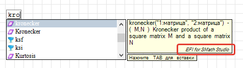

Yes, it is possible. I didn't update the plugin. I only changed the SMath Studio Desktop exe file.
efi.txt
efi.txt
23.02.2014 16:55:11 [CreateUserFunction] Tsat_p - [Steamtables.dll] [ a ] Saturation temperature
23.02.2014 16:55:11 [CreateUserFunction] T_ph - [Steamtables.dll] [ a, b ] Temperture as a function of pressure and enthalpy
23.02.2014 16:55:11 [CreateUserFunction] T_ps - [Steamtables.dll] [ a, b ] Temperture as a function of pressure and entropy
23.02.2014 16:55:11 [CreateUserFunction] T_hs - [Steamtables.dll] [ a, b ] Temperture as a function of enthalpy and entropy
23.02.2014 16:55:11 [CreateUserFunction] psat_T - [Steamtables.dll] [ a ] Saturation pressure
23.02.2014 16:55:11 [CreateUserFunction] p_hs - [Steamtables.dll] [ a, b ] Pressure as a function of h and s
23.02.2014 16:55:11 [CreateUserFunction] p_hrho - [Steamtables.dll] [ a, b ] Pressure as a function of enthalpy and density
23.02.2014 16:55:11 [CreateUserFunction] hV_p - [Steamtables.dll] [ a ] Saturated vapour enthalpy
23.02.2014 16:55:11 [CreateUserFunction] hL_p - [Steamtables.dll] [ a ] Saturated liquid enthalpy
23.02.2014 16:55:11 [CreateUserFunction] hV_T - [Steamtables.dll] [ a ] Saturated vapour enthalpy
23.02.2014 16:55:11 [CreateUserFunction] hL_T - [Steamtables.dll] [ a ] Saturated liquid enthalpy
23.02.2014 16:55:11 [CreateUserFunction] h_pT - [Steamtables.dll] [ a, b ] Entalpy as a function of pressure and temperature
23.02.2014 16:55:11 [CreateUserFunction] h_ps - [Steamtables.dll] [ a, b ] Entalpy as a function of pressure and entropy
23.02.2014 16:55:11 [CreateUserFunction] h_px - [Steamtables.dll] [ a, b ] Entalpy as a function of pressure and vapour fraction
23.02.2014 16:55:11 [CreateUserFunction] h_Tx - [Steamtables.dll] [ a, b ] Entalpy as a function of temperature and vapour fraction
23.02.2014 16:55:11 [CreateUserFunction] h_prho - [Steamtables.dll] [ a, b ] Entalpy as a function of pressure and density. Observe for low temperatures (liquid) this equation has 2 solutions. (Not valid!!)
23.02.2014 16:55:11 [CreateUserFunction] vV_p - [Steamtables.dll] [ a ] Saturated vapour volume
23.02.2014 16:55:11 [CreateUserFunction] vL_p - [Steamtables.dll] [ a ] Saturated liquid volume
23.02.2014 16:55:11 [CreateUserFunction] vV_T - [Steamtables.dll] [ a ] Saturated vapour volume
23.02.2014 16:55:11 [CreateUserFunction] vL_T - [Steamtables.dll] [ a ] Saturated liquid volume
23.02.2014 16:55:11 [CreateUserFunction] v_pT - [Steamtables.dll] [ a, b ] Specific volume as a function of pressure and temperature.
23.02.2014 16:55:11 [CreateUserFunction] v_ph - [Steamtables.dll] [ a, b ] Specific volume as a function of pressure and enthalpy
23.02.2014 16:55:11 [CreateUserFunction] v_ps - [Steamtables.dll] [ a, b ] Specific volume as a function of pressure and entropy.
23.02.2014 16:55:11 [CreateUserFunction] rhoV_p - [Steamtables.dll] [ a ] Saturated vapour density
23.02.2014 16:55:11 [CreateUserFunction] rhoL_p - [Steamtables.dll] [ a ] Saturated liquid density
23.02.2014 16:55:11 [CreateUserFunction] rhoV_T - [Steamtables.dll] [ a ] Saturated vapour density
23.02.2014 16:55:11 [CreateUserFunction] rhoL_T - [Steamtables.dll] [ a ] Saturated liquid density
23.02.2014 16:55:11 [CreateUserFunction] rho_pT - [Steamtables.dll] [ a, b ] Density as a function of pressure and temperature.
23.02.2014 16:55:11 [CreateUserFunction] rho_ph - [Steamtables.dll] [ a, b ] Density as a function of pressure and enthalpy
23.02.2014 16:55:11 [CreateUserFunction] rho_ps - [Steamtables.dll] [ a, b ] Density as a function of pressure and entropy.
23.02.2014 16:55:11 [CreateUserFunction] sV_p - [Steamtables.dll] [ a ] Saturated vapour entropy
23.02.2014 16:55:11 [CreateUserFunction] sL_p - [Steamtables.dll] [ a ] Saturated liquid entropy
23.02.2014 16:55:11 [CreateUserFunction] sV_T - [Steamtables.dll] [ a ] Saturated vapour entropy
23.02.2014 16:55:11 [CreateUserFunction] sL_T - [Steamtables.dll] [ a ] Saturated liquid entropy
23.02.2014 16:55:11 [CreateUserFunction] s_pT - [Steamtables.dll] [ a, b ] Specific entropy as a function of pressure and temperature (Returns saturated vapour entalpy if mixture.)
23.02.2014 16:55:11 [CreateUserFunction] s_ph - [Steamtables.dll] [ a, b ] Specific entropy as a function of pressure and enthalpy
23.02.2014 16:55:11 [LoadLibraries] C:\Users\саша\AppData\Roaming\SMath\extensions\plugins\91a20d24-c30b-4774-9b1b-4d502a80420f\1.0.4977.35617\userefi\Steamtables.dll loaded.

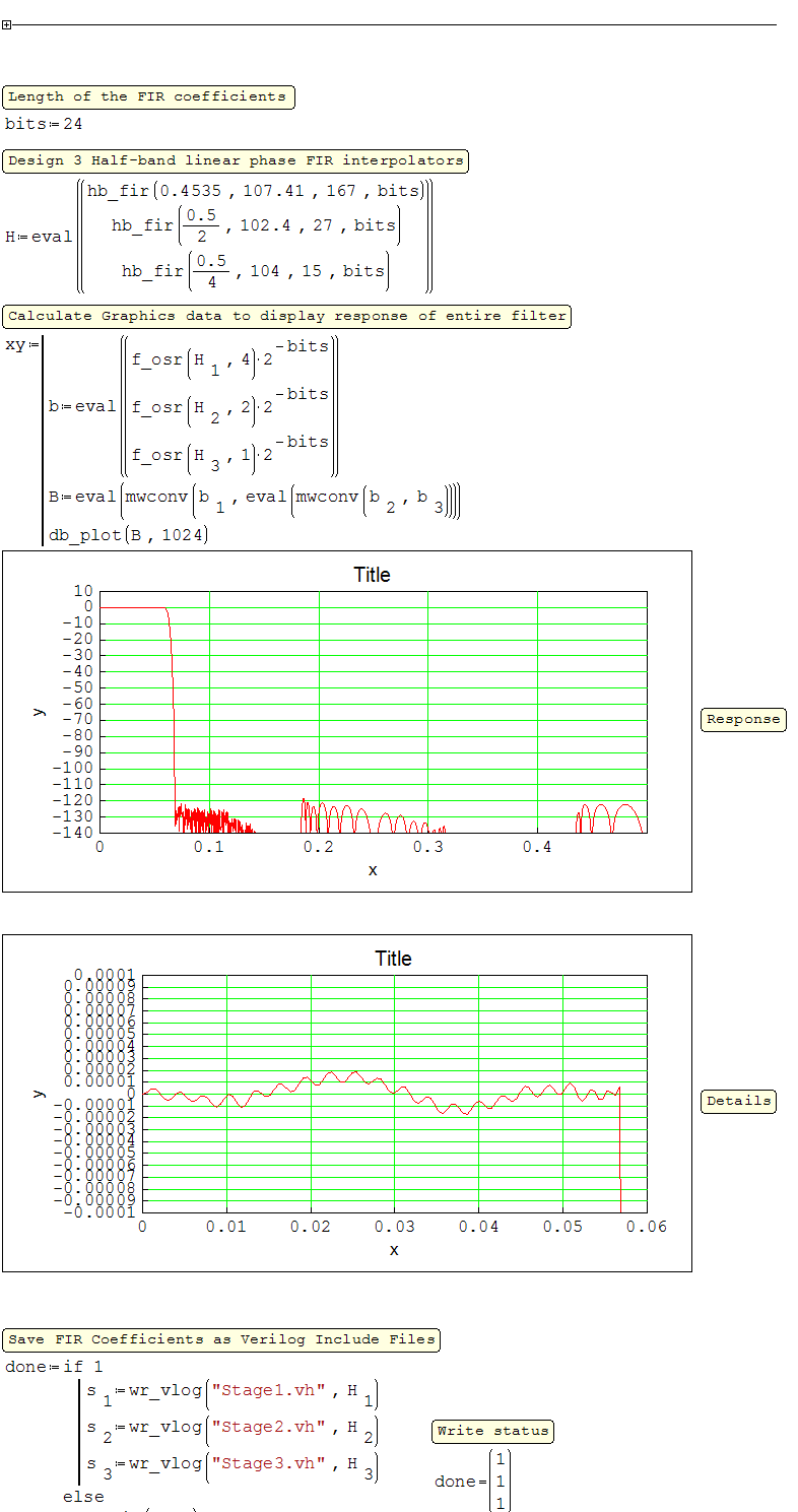

#85 Posted: 3/13/2014 12:44:46 PM
This is my remez2.dll. Usually it works a little better than Matlab tools.
You can design FIR band-pass/stop filters up to length~2000.
The example is audiophile's "holy" NPC SM5842 8X interpolating digital filter.
Before starting the program, do not forget to put remez2.dll in the plugin's \userefi folder.

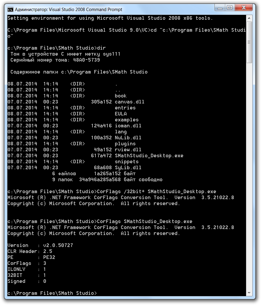

#86 Posted: 3/17/2014 8:00:47 PM
SMathStudio_Desktop_0.97.5189_32bit
How to get this 32-bit version (MSVS2010):
CorFlags /32bit+ SMathStudio_Desktop.exe
#87 Posted: 6/21/2014 7:54:52 AM
Radovan Omorjan 6/21/2014 10:50:00 AM
#88 Posted: 7/8/2014 4:21:38 AM
#89 Posted: 7/8/2014 1:18:06 PM
I'm not a programmer, so VS2010 is not a good option. Simple patch is preferable
So far the flags bits are at the same location for all SMath versions.
Just use HEX editor to write one byte 0x03 to absolute address 0x00000218 in the SMathStudio_Desktop.exe.
Good luck !!
Good luck !!

When the program is running, the mcadefi.log file (located next to the mcadefi.dll) will show the number of loaded functions:
30.05.2020 03:11:45 [INFO ] [Plugin.Initialize()] OS: Microsoft Windows NT 6.2.9200.0
30.05.2020 03:11:45 [INFO ] [Plugin.Initialize()] .Net: 4.0.30319.42000
30.05.2020 03:11:45 [INFO ] [Plugin.Initialize()] 32-bit
30.05.2020 03:11:45 [INFO ] [Plugin.Initialize()] EFI for SMath Studio, version 1.0.7165.40625, 14-авг-2019 22:34:10
30.05.2020 03:11:45 [INFO ] [Plugin.Initialize()] Psi(1) - ( z ) Digamma function for complex z
30.05.2020 03:11:45 [INFO ] [Plugin.Initialize()] kronecker(2) - ( M,N ) Kronecker product of a square matrix M and a square matrix N
30.05.2020 03:11:45 [INFO ] [Plugin.Initialize()] Successfully. 2 function(s) loaded.

#96 Posted: 5/30/2020 1:30:16 AM
Step 0. Copy CorFlags.exe to the program folder.
Step 1. Start command console with administrative privileges.
Step 2. Move to the program directory:
Step 3. Set the 32-bit flag to 1 (don't forget about spaces):
Step 4. Check the flag value (32BITREQ must be 1):
Result:
Command to return back 32-bit flag value (32BITREQ must be 0):
cd "c:\Program Files (x86)\SMath Studio"
CorFlags.exe /32bit+ SMathStudio_Desktop.exe
CorFlags.exe SMathStudio_Desktop.exe
Result:
Version : v2.0.50727
CLR Header: 2.5
PE : PE32
CorFlags : 0x3
ILONLY : 1
32BITREQ : 1
32BITPREF : 0
Signed : 0
CorFlags.exe /32bit- SMathStudio_Desktop.exe
