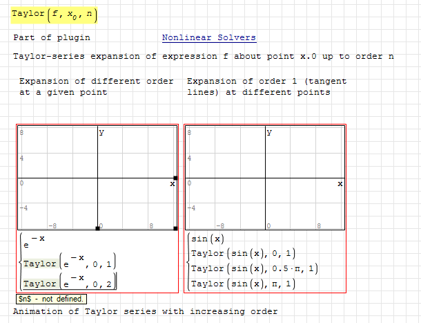

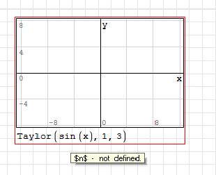

I found that if I try to draw a function in 2d plot using Taylor function, then it shows the error "$n$-not defined.
From the Martin's Handbook as well
#3 Опубликовано: 15.10.2019 14:29:02
Confirmed: it stopped working between SS 5346 SS 6179

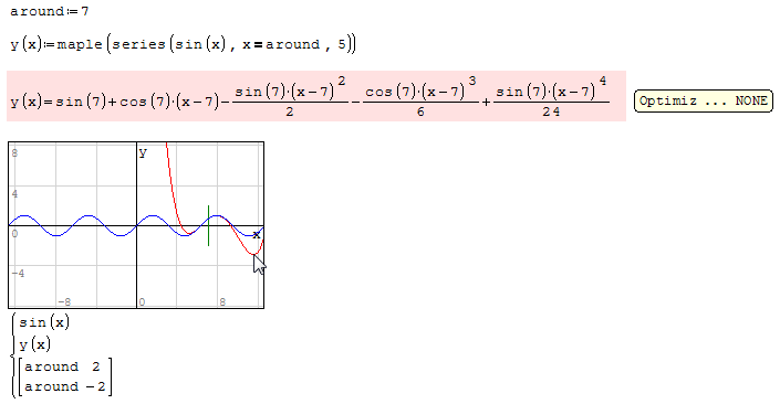

Maple series.sm (36,51 КиБ) скачан 1270 раз(а).
