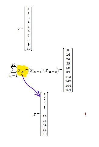

You could use a plugin; plugins can perform those recursive iterations outside of the SMath Worksheet environment, thus speeding up your runtime.
Another thought would be to use the recursive features already pre-programmed into SMath (e.g., use of Factorial, Summation, Integral) instead of utilizing the 'programming' functions of for/while.
For example, I used the summation to modify the elements of variable 'y' to reference the previous variables of 'y' and thus created a Fibonacci Sequence in fractions of a second:
Hope this is of help,
-Kenny Lemens, P.E. ᵂᴵ
