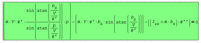

Hello to all I solved this differential equation: I wanted to know if the procedure I used is correct… this is the .sm file… vel-imb.sm(25,61 КиБ) скачан 1098 раз(а). Thanks in advance
I wanted to know if the procedure I used is correctâ¦
Maybe it is correct. The solver you use is transmitted Unicode ? not digestible as is. Why not stay Native Smath ODE Solver(s) ? ... as doctored/attached SS 6179
