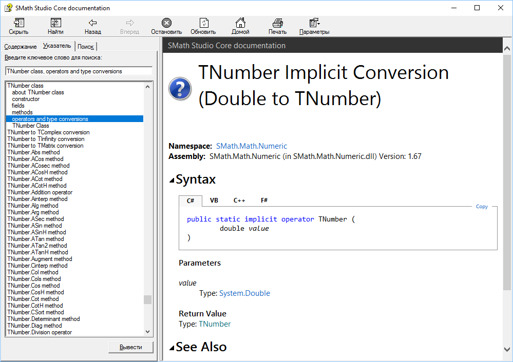

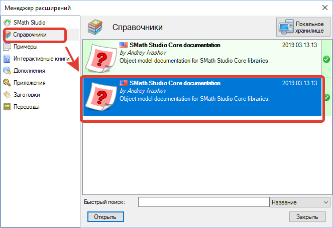

I recommend making a copy of the repository on a local disk and then looking for code examples in it.
Also, right in the program there is a user's guide (or Core documentation).
[TNumber].obj.ToDouble() - convert to double

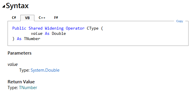

New TNumber( double, double ) or CType( double, TNumber ) - for back operation, but I'm not sure how it will look in basic. There is an implicit conversion operator.
