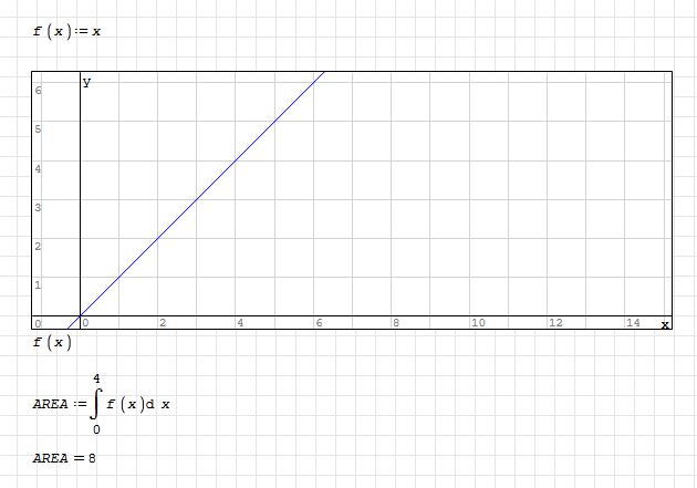

Hi All,

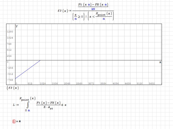

Anyone can help to point me how to integrate equation between a range to find the area unde the curve / function. Been trying loads of way to change the integral equation, but no luck.
Manage to get this done in a simple equation, however can't get when there is a vector
Thanks

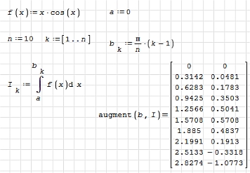

Hi. For do things between a range you have several options in SMath, like vectorize() or for loops. This is using range variables:
Isn't clear which range do you want in X.point(x)
