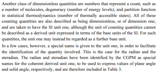

Radian, degrees and "gradients" (***) are units for measure angles, which "loss" their dimension because are evaluated a quotient of two lengths.
2*Pi*radius is for the entire circle length, not for the arc in the definition of radian.

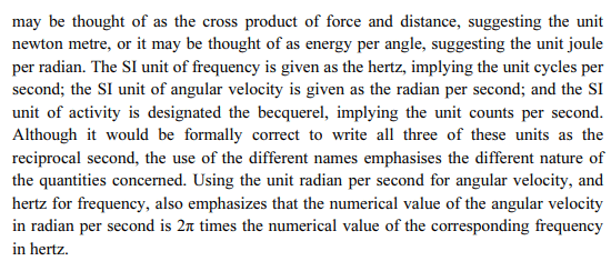

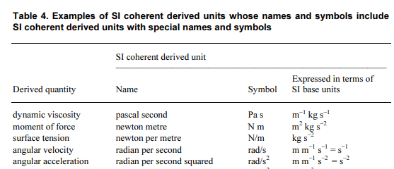

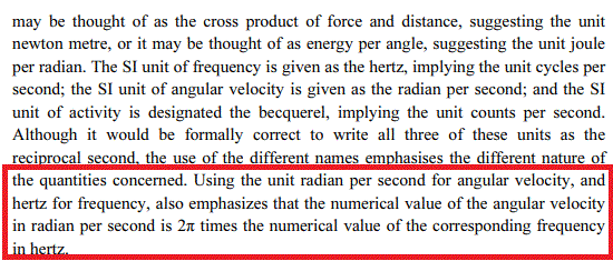

Nope. radian per second it is 1/s. In can't derive that from the animation, check the Official standard, from https://www.bipm.org/utils/common/pdf/si_brochure_8_en.pdf
Pages 119 - 120

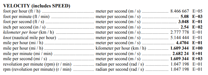

Thus, SMath it's correct. Maybe what your friend needs to use is rpm, which have also a correct definition in SMath. It isn't in the BIPM bureau but can find it at NIST: https://physics.nist.gov/cuu/pdf/sp811.pdf

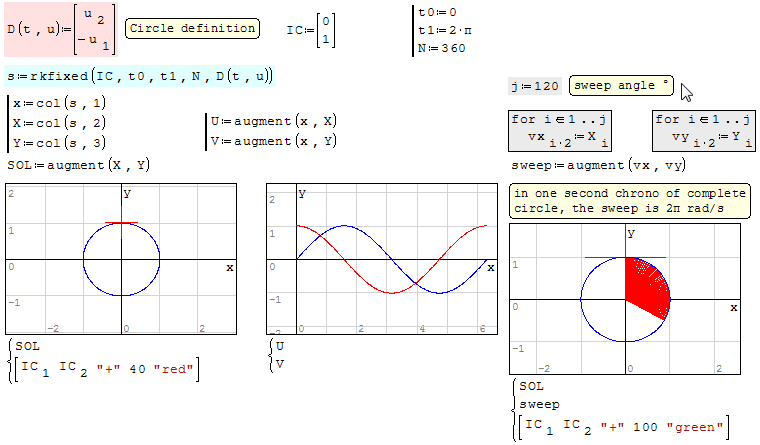

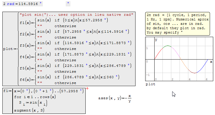

1rad/s reflects the speed of a flat angular motion [circular/elliptical motion]
More confusing is the numerical approximation of sin(x), cos(x) ...
The argument 'x' is rad.
The visitors may complete the X_Y plot attached.
Maths sin(deg) plot.sm (17,61 КиБ) скачан 1186 раз(а).
See the line about Hz. Don't we need this in SMath Studio?

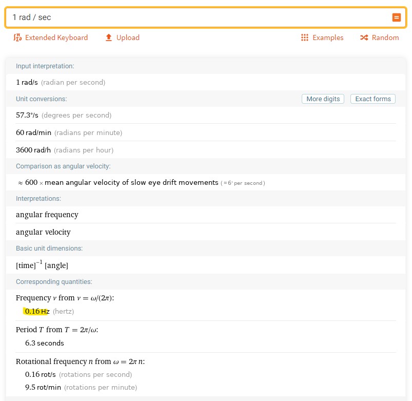

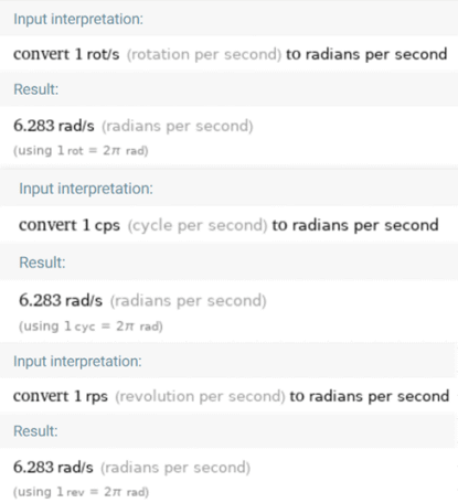

Hi. You can introduce definitions for cycle, rotation and revolution. In Wolfram alpha all are the same, but I think you might find this discussion interesting, where my choice for cycle is cycle:=1, not 2 Pi.
https://community.ptc.com/t5/PTC-Mathcad/Curve-fitting-units/m-p/499667
Naming rev or rot as 'rev:=2*Pi you can handle those values that appear in wolfram alpha.
From https://www.wolframalpha.com/input/?i=rot+%2Fs+in+rad%2Fs and similar:

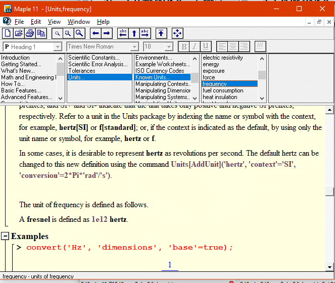

Finally, you can implement more complicate solutions, like this one in maple:
Andrey Ivashov 19.12.2020 20:05:00
WroteYou can introduce definitions for cycle, rotation and revolution. In Wolfram alpha all are the same,
That's what I have explained above. At least, Wolfram conforms to the ancestors !
