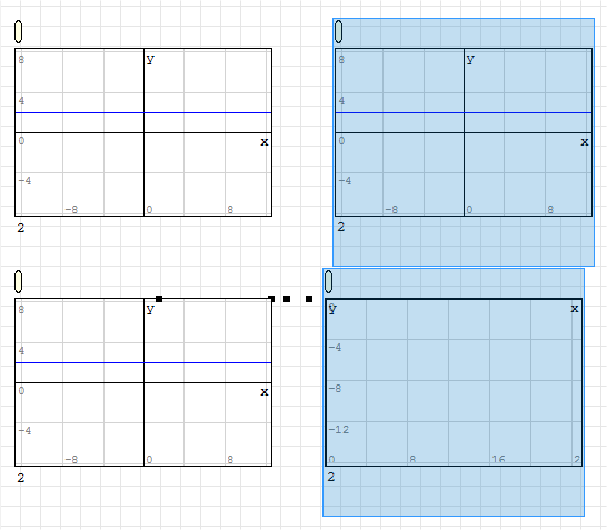

Some issues when copying CustomRegions (like built-in 2D plots) with CTRL+drag:
- when the description is enabled cause an oversized selection of the output; if the base region have a description and is disabled, some glitches appears
- if you select the original region and you change the font size, the clone have the same font-size of the original (CTRL+V display the output with the correct font-size)
#2 Опубликовано: 01.08.2013 19:09:40
Thank you! I'll check it.
