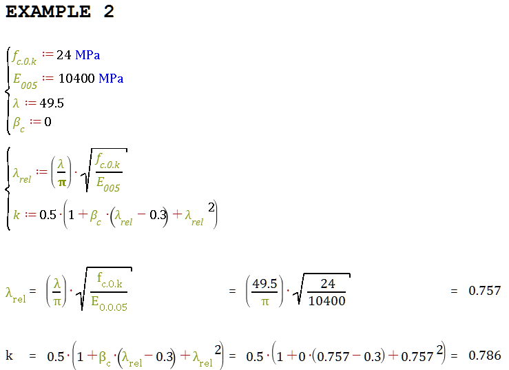

I have been trying to display the numbers in equations for a while now.
After experimenting with the table extension, I think I have discovered a method.
It is far from clean, and requires some manual input, and therefore is not feasible for one-off documents.
Yet, when reusing recurring documents that will be checked by others, this might useful.
Theres plenty to improve. For example, a function returning the defined content of an equation, without variable substitutions would really help.
*See updated file in last post*

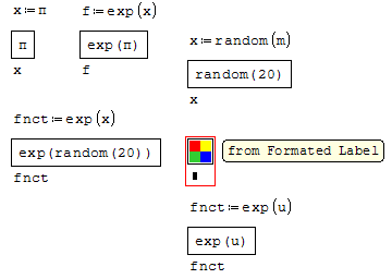

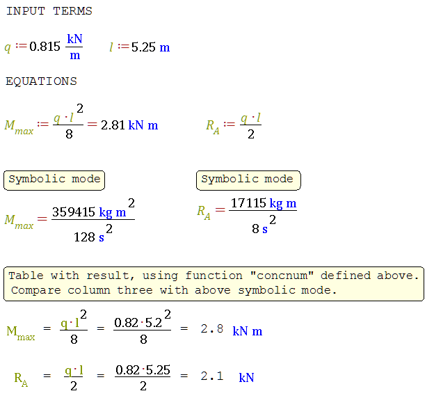

Is that what you are trying to do ?
No, Jean, that is not what I am attempting. The formated label combines values and does not work with units, similiar to symbolic mode. Since you often refer to mathcad, this function is similiar to the matchad explicit function.
Here is an updated version, now working with more equations

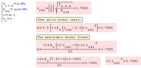

#6 Опубликовано: 20.04.2018 09:30:49
With respect to the exportable kernel format and your image -
I apologize for my lack of knowledge, but I do not understand what you mean
Projects often require lot of front-end maths to conclude/export a formula
that you can pass to the Engineering design team. Two examples attached.
Sweden.sm (28,02 КиБ) скачан 1293 раз(а).
Thiele Procedure QUICK Simplify_Collect Copy.sm (77,02 КиБ) скачан 1394 раз(а).
