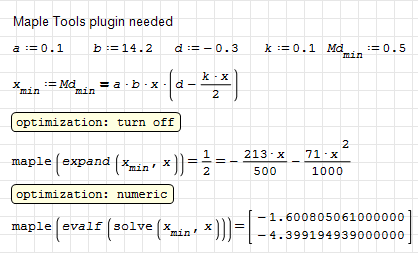

I need this display after the expand
https://ibb.co/Sfmj1jz
#7 Опубликовано: 09.12.2021 13:07:56
TIAGO C DOS SANTOS
TIAGO C DOS SANTOS
1 сообщений из 27 понравились пользователям.
Hi Tiago. This is one way.
I need the blue rectangle to be the same as the yellow one, is this possible?
https://ibb.co/2n6Np5C

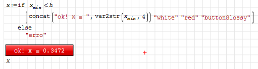

#8 Опубликовано: 09.12.2021 13:19:40
not the end result but what is between expand and solve
#10 Опубликовано: 09.12.2021 17:45:02
The polynomial coefficients?

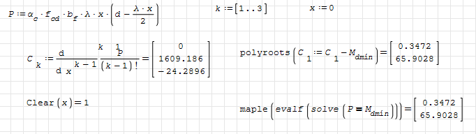

#12 Опубликовано: 09.12.2021 21:20:19
If this is your doctrine ... superb !
There is an Smath document that constructs polyroots.
#16 Опубликовано: 10.12.2021 17:04:29
i need to show the students step by step how to perform the calculations
What construction/calculation step by step ?
Not possible to easily write all those functions in one line.
It can be done with serious alterations but shall not be practical.
I posted something similar to another user. But again, I wouldn't use it.
Just write functions and solves in multiple lines.
