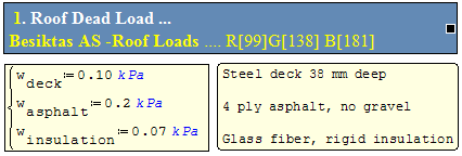

Hello.
Workaround suggested by Sergio works for me.
In addition I would suggest to use the latest features implemented in SMath Studio: Header/Footer and Full page background together with correct margins. Here is what I get as a result:
BackgroundTest_mod.sm (397,26 КиБ) скачан 1333 раз(а).
Regarding performance - I will fix it soon.
