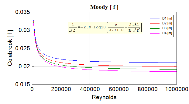

XP Home scraped all my Excel Win Me.
Who cares Excel, not a CAS vs Smath.
All my tools are perpetual, some more ancient than 2000.
1. CutePDF
2. Adobe 100%
Perfect for publishing, so quick !
Moody.pdf (70,73 КиБ) скачан 636 раз(а).
#22 Опубликовано: 02.10.2019 22:18:50
Note the difference of as-printed quality
between X-Y Plot output and excel_EMF output.
X_Y plot has plenty of options: quality or preference.

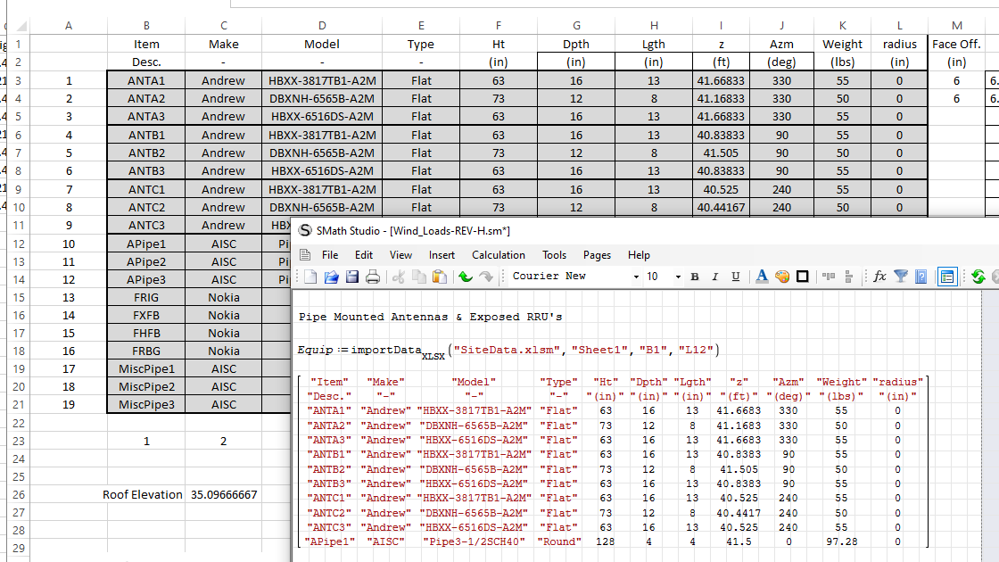

overlord:
are you trying to bring in a chart or data table into SMath? your original post referred to table data.
can you use Alex's EXCEL I/O plug in to read in the table directly?
i use it to grab arrays out of excel. with a bit of clever formatting, you can bring in units as well if they are syntaxed correctly.
i find it MUCH easier to edit and manipulate arrays in Excel than in SMath.
here is a snip with SMath and the excel sheet it imports from below.

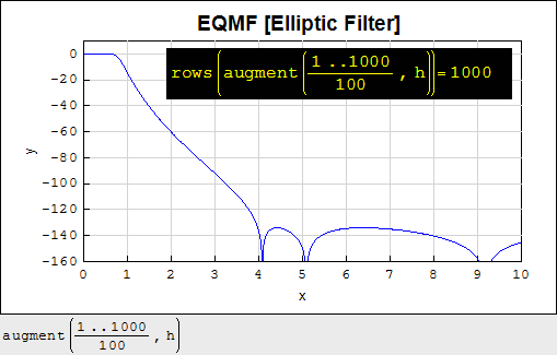

Pure tip to plot points as symbol, superposed/overposed
over other range of data on same X_Y trace.
Example: Isometric just posted [too small screen to caliper].
#28 Опубликовано: 03.10.2019 14:27:57
i have just used it for an easy examle of displaying excel with no quality loss
You mean: compare X_Y vs Excel ... X_Y of equal fineness ?
Post the maths that plot X_Y ... looks interesting.
