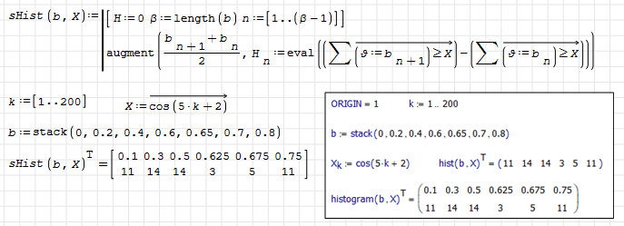

Hi Valery. This function returns the same result as mathcad.
sHist.sm (15,24 КиБ) скачан 782 раз(а).
Valery Ochkov 11.10.2023 01:53:00, Oscar Campo 11.10.2023 01:24:00

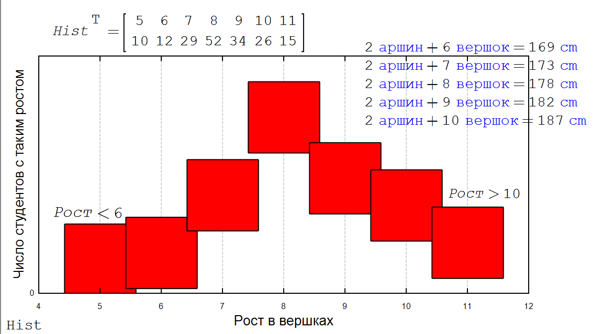

My students histogram

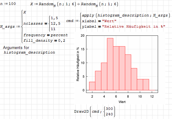

Maxima has a histogram plot function.
Taken from DOI: 10.25933/opus4-2949. The PDF has attached SMath documents.
Are you looking for something more ;like this?
Valery Ochkov 11.10.2023 20:23:00

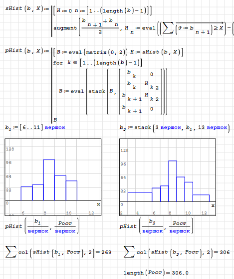

Hi. This version also works with unequally spaced bins.
pHist Mister-Class.sm (61,58 КиБ) скачан 774 раз(а).
Valery Ochkov 11.10.2023 20:24:00

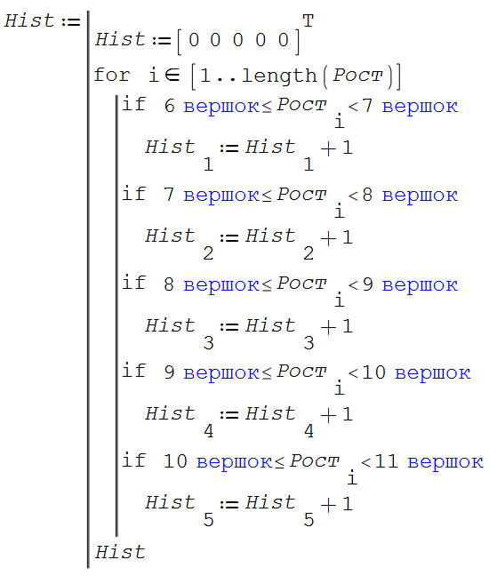

A Live histogram

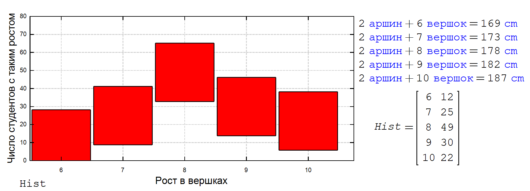

My KISS Histogram

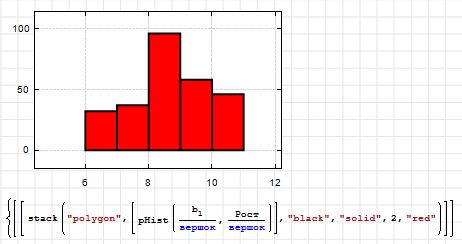

Hi. You can use the above pHist within XYPlot.
