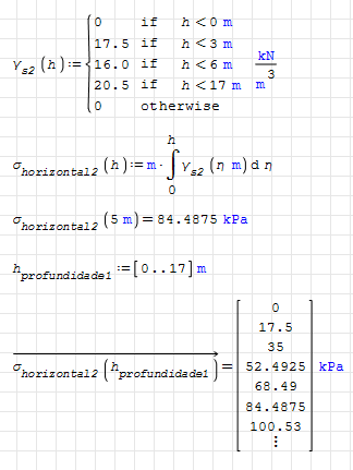

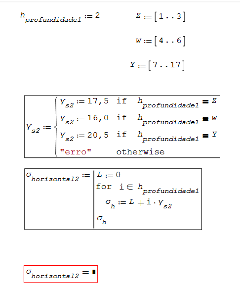

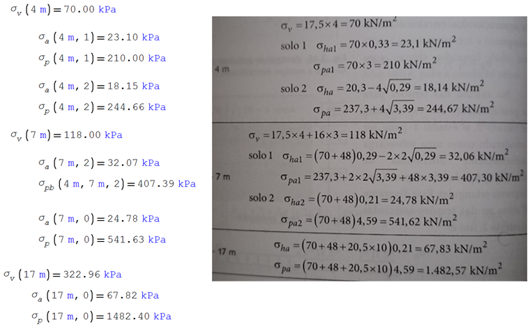

Good afternoon, could someone explain to me how to solve this problem I need that the horizontal voltage varies according to the depth however and the s2 gamma.
my input data is hprofundidade1 z w and y

I didn't understand what to calculate in sigma function.
A little more explanation would help to resolve it.

Good morning,
I reworded the file with an SPT matrix, my goal is to loop to find the value of sigma h in the depth that I inform in the input I am attaching a photo of what the final result should look like with the graph
TESTE TENSAO ADM MATRIZ.sm (13,15 КиБ) скачан 1071 раз(а).

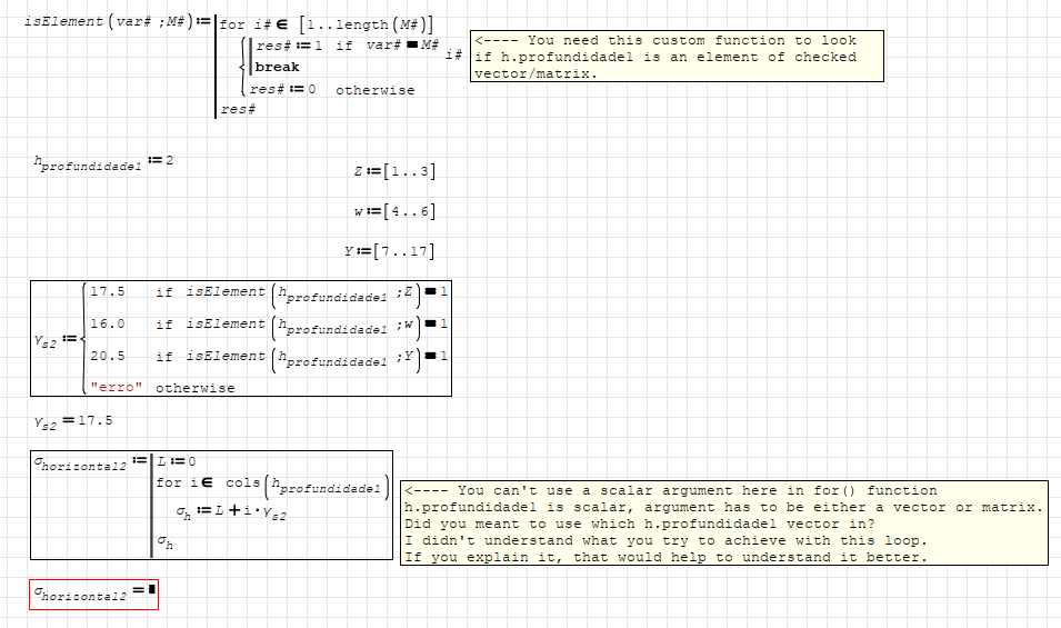

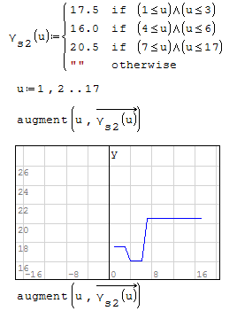

Hi. I think that this could be the solution.
TESTE TENSAO ADM MATRIZ.sm (5,88 КиБ) скачан 1065 раз(а).

I still don't understand purpose of for() loops. (not in your solution, original question)
Removing for()'s and calculating directly won't change the result.

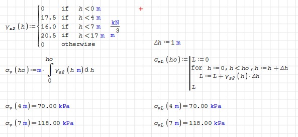

Hi overlord. I guess because using γ.s2(h)*h isn't correct, there the correct acumulation is γ.s2(h)*Δh
TESTE TENSAO ADM MATRIZ.sm (10,8 КиБ) скачан 1042 раз(а).
WroteWrotethank you all for making your time available, helping me with this problem but some of the solutions posted here do not match the values must be equal to sigma,v in the image or 70 kN/m2 at 4m depth and 118 kN/m2 at 7m depth.

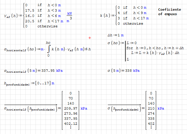

TESTE TENSAO ADM MATRIZ (in_situ parametric).sm (18,6 КиБ) скачан 1120 раз(а).
PERFECT FELL LIKE A GLOVE is there a way to rotate the result of the graph 90 degrees?

Thank you all for making your time available, helping me with this problem but some of the solutions posted here do not match the values must be equal to sigma,v in the image or 70 kN/m2 at 4m depth and 118 kN/m2 at 7m depth.
see the resolution of the problem in the attached image
