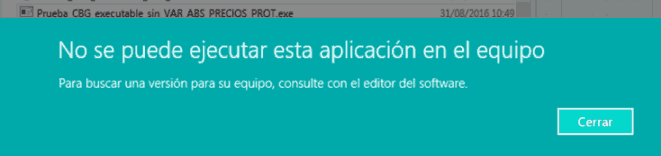

If you protect a region with a password, and this region is closed , to save the "sm " executable ( " .exe" ) Smath Viewer Pro file is not recognized as a Windows executable .
and if you save it as " exe " file Smath Viewer free , the file is saved correctly and is recognized by windows , but there is no way that within the executable , you can open the protected region.

With a simple example, Smath Viewer, stopped working . Annex example

#4 Опубликовано: 01.09.2016 05:44:32
Thank you! I see the problem is related in some way with the separator as first region (title modified). There is a conflict between the separator title and the collapsed encrypted area.
Bug added in the BTS (SV-2373), I'll investigate code-side ASAP.
