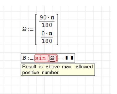

can someone help me with the following error message and what is wrong here:
Thanks!

this does the trick!

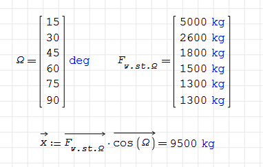

Now I need to multiply two arrays of values and get a third array of values. This is very easy. For some reason I get just one figure instead of array. What is wrong here and how to solve this?

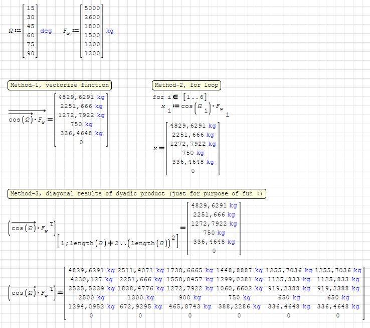

#9 Опубликовано: 06.05.2021 20:12:39

#11 Опубликовано: 06.05.2021 20:28:20
There are different methods you can use.
You either multiply with vectorize function. Sometimes this function will not avail.
Or multiply the elements piece by piece with for loop, in some cases this is the only way.
Or calculate dyadic product and take the transverse results of it. Why? because you can (swh).
