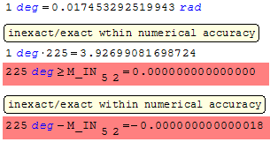

Dear all,
In a cam profile generation program, I perform some boolean operations with angular values (input in degrees).
I noticed some boolean operations fail due to a varying accuracy.
The file in attachment will clarify what I mean.
How can I make these values equal? Reduce the amount of significant numbers?
Thanks in advance for any feedback!

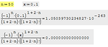

... differently puzzling: set n 49, 50

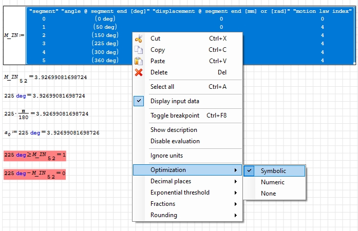

#4 Опубликовано: 12.05.2022 18:30:06
...Accuracy.sm (7,11 КиБ) скачан 1597 раз(а).
Choose symbolic optimization in the matrix definition.
janclaeys 12.05.2022 21:04:00, Davide Carpi 13.05.2022 05:29:00
#5 Опубликовано: 13.05.2022 09:44:14
How can I make these values equal ?
Leave the main matrix numeric, explore Numeric/Symbolic in-situ
The two Boleans disagree ... IMHO, Numeric is the practical procedure.
