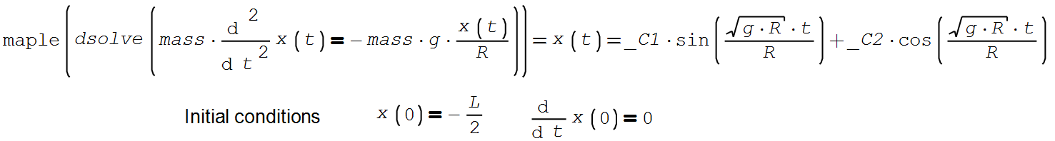

See please one ODE symbolic solution without IC
dsolve.sm (4,93 КиБ) скачан 1287 раз(а).

"L & m" are missing in dsolve result ?
m is missing in dsolve.

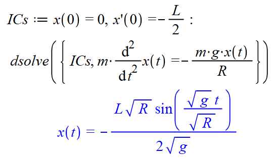

Hi Valery. Use Ctrl+Shift+K for write D(x)(0), which means x'(0)
Thanks!
dsolve-ICs.sm (10,61 КиБ) скачан 1306 раз(а).

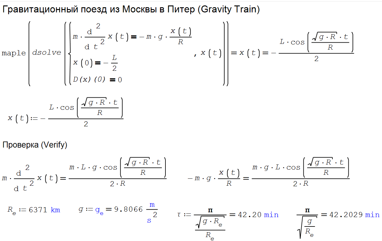

The distance between the cities added.
GravityTrain.sm (31,01 КиБ) скачан 1242 раз(а).
GravityTrain.pdf (233,1 КиБ) скачан 764 раз(а).

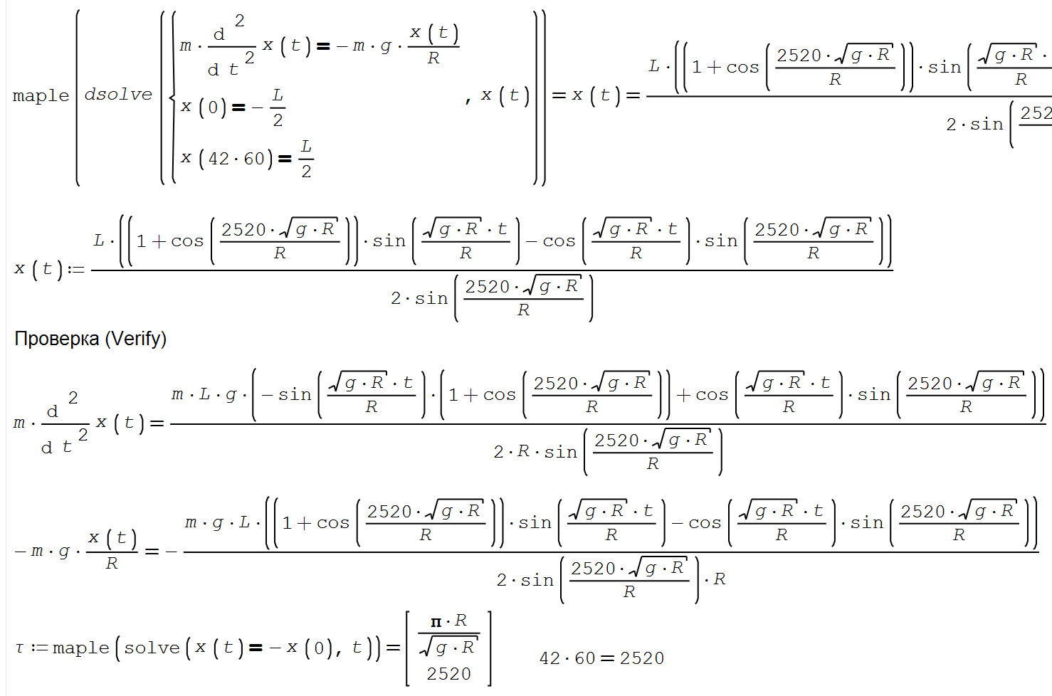

The Boundary problem?
dsolve-Boundary.sm (17,01 КиБ) скачан 1277 раз(а).
