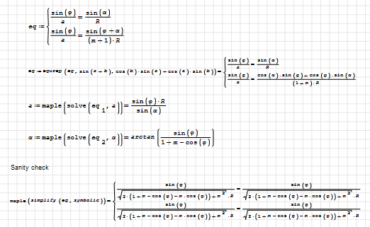

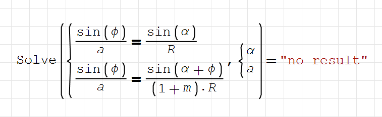

Thanks Jean,
Both a and alpha are unknows.
the result of a and alpha are still includes these unknows.
Only φ, R and m are knowns and can be used in the results.
#3 Опубликовано: 20.02.2022 10:12:56
netsonicyxf
netsonicyxf
2 сообщений из 79 понравились пользователям.

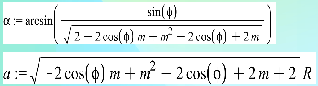

Thanks Jean,
Buy you 2nd sybolic solution is the same as the 1st one.
The solution should not include the unknow a and alpha
My friend use Maple to get symbolic solution like this
You can see that in the solution of alpha, there is no a, in the solution of a, there is no alpha.

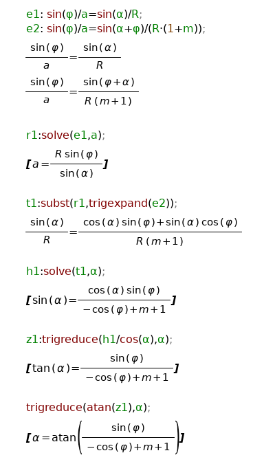

#4 Опубликовано: 20.02.2022 20:29:51
Symbolic solver of maxima is not that capable.
As far as I know of course, maybe there is a simpler way.
But this statement was what I had read about it.
You have to use some substitutions for that solutions.
And some extra division, arc functions, visa versa.
Here is α solved symbolically in wxMaxima.
Same method can be applicable for variable a.
untitled.wxmx.zip (1,6 КиБ) скачан 315 раз(а).

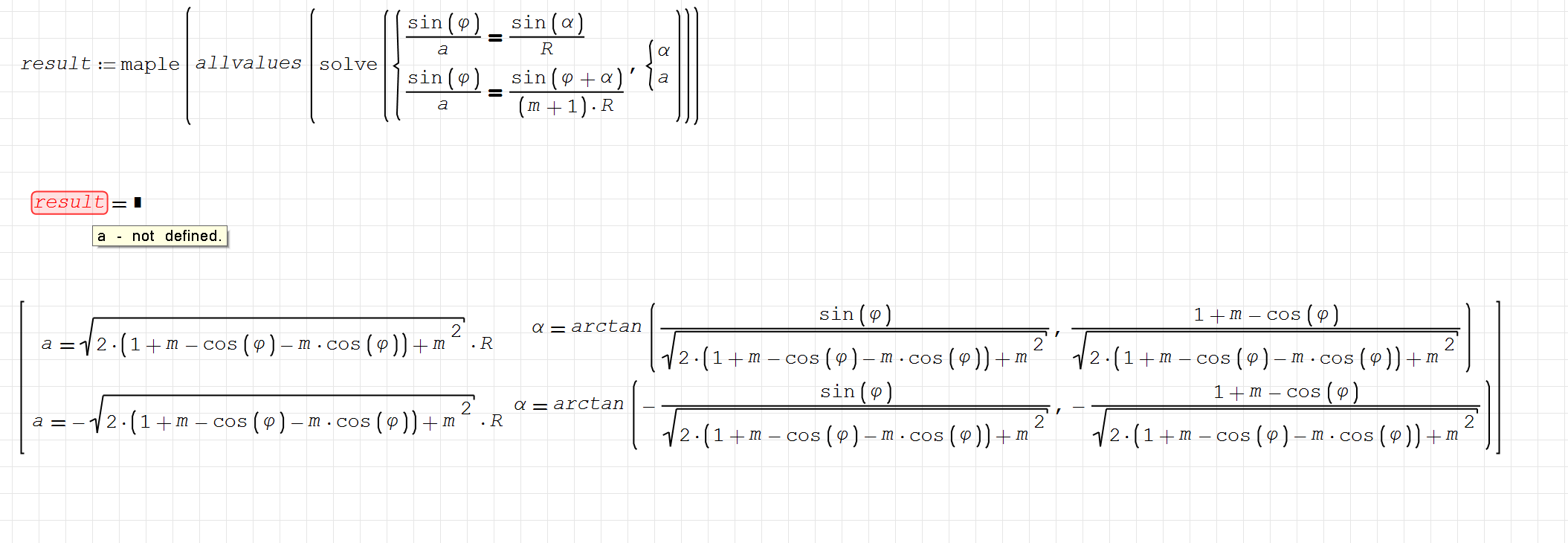

#7 Опубликовано: 22.02.2022 11:55:34
Is Maple plugin in Smath able to get symbolic results as Maxima does, but more easily?
Maple is easier to use, that is a fact.
And sometimes it gives better results.
But Maxima can surpass Maple at certain aspects.
Use what suits your needs most.
In the example below, I solved your function with Maple.
Though it gives the results correct, result matrix is cripled.
Copying and changing last bits of result ";2;1)" to ";2;2)" will correct the result.
";" may differ to "," according to your arguments separator.
Worksheet1.sm (15,97 КиБ) скачан 1146 раз(а).

Hi overload,
When I open you sm I get this error
#9 Опубликовано: 16.04.2022 09:57:28
netsonicyxf
netsonicyxf
... is that what you are looking for ?
No
The two equations should be put in one system.
#10 Опубликовано: 16.04.2022 12:26:22
churichuro
churichuro
29 сообщений из 79 понравились пользователям.
Hi overload,
appears in red, because the evaluation must be symbolic.
select the "result" variable, press the right button and in the type of evaluation select symbolic and that's it.
I hope I have served you, greetings

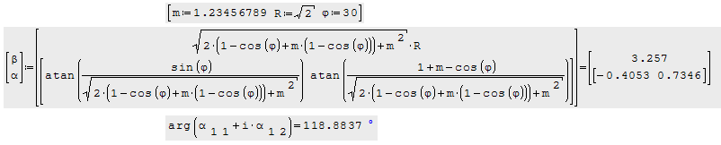

#12 Опубликовано: 17.04.2022 08:32:35
Thanks Jean,
Both beta and alpha are unknown.
the result of beta and alpha still include these unknowns.
Onlyφ, R and m are known and can be used in the results.
... to be used as productive.
Your system is baby stuff, example 2 advanced.
I leave it there, not knowing more about your end demand.
Simply a solved formula representation ???
Comment or ignore ... Jean.
Solve ADVANCED Productive.sm (22,64 КиБ) скачан 1101 раз(а).
