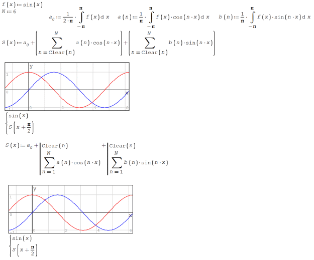

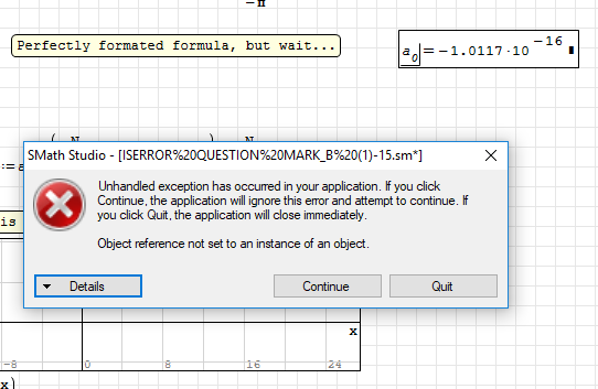

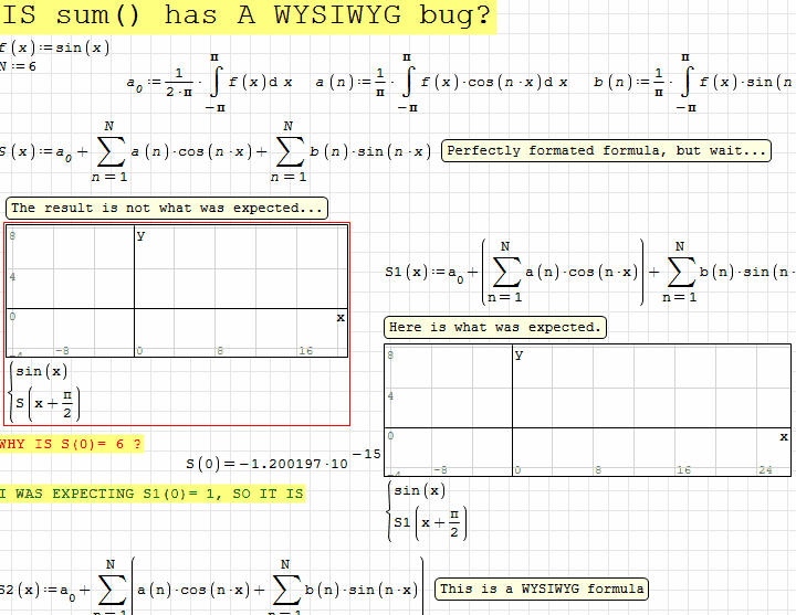

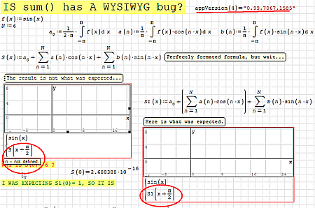

Attached sm file which appeared recently in the forum works in 7030 (stable), but throws errors in 7067 (Beta).
Some times it crashes when trying to evaluate some variables.
ISERROR QUESTION MARK_B (1).sm (18,72 КиБ) скачан 790 раз(а).

Confirmed,
Sometimes crashed (red cross over the screen) and sometimes didn't.

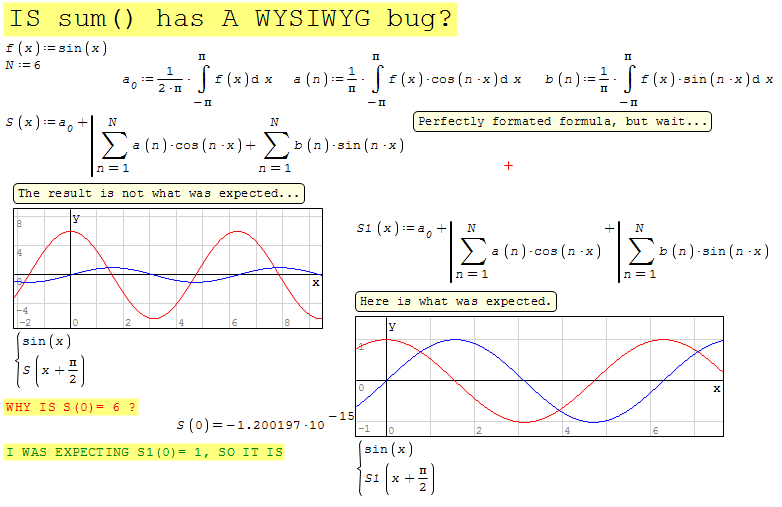

Hi. I don't see a bug here, but some kind of issue handling n. About the WYSIWYG notation, it's well know this kind of difficulties not only in SMath, but in mathcad, maple and mathematica too. About the issue with n it must to be solved using Clear, because n isn't local in the sum.
ISERROR QUESTION MARK_Clean.sm (10,4 КиБ) скачан 773 раз(а).

This problem with summation will come up here and there. It would be enough to put the summation terms inside a single line environment. This behaviour is present in SMath for quite a while. This is easy to forget, but it should not have crashed in those cases. The problem is how to remember this issue and overcome situations like this one.

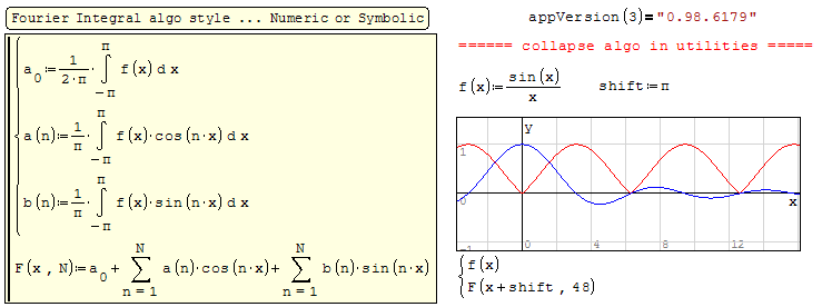

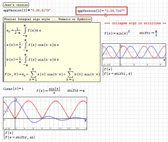

Try this Fourier-algo style.
Fourier Integral Algo Style.sm (7,66 КиБ) скачан 744 раз(а).
Leave default integral acc 100, only 'N'
Rejects SQRT(x) but takes SQRT|(x)|
Try more ... let us know about your version ... Jean

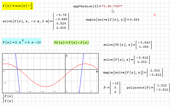

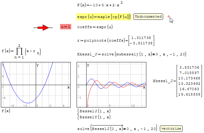

The attached sm file also crashes some times when inputs to Polyroots, solve, maple(solve)
are changed or adjusted.
Roots_Ex1.sm (16,06 КиБ) скачан 737 раз(а).

Tried but it did not crash.

I had 2 or 3 crashes while testing. It was very strange.
I will try more variations and post if there is any crash.
That shouldn't happen, but maybe on latest beta.
1. Polynomials have unique Lagrange format [lot many books are wrong].
2. maple(op(F(u))) will save you manual steps and possible typo errors.
Maths eigenAll Companion.sm (62,14 КиБ) скачан 715 раз(а).

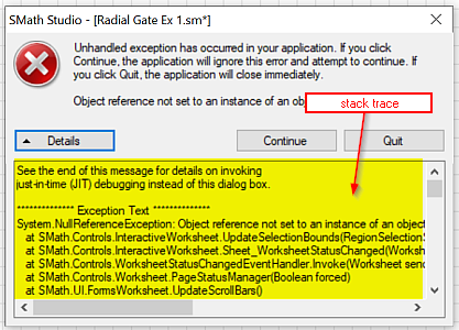

Please remember to copy and attach here the stack traces when you encounter such critical errors, especially if they are not easily reproducible like this.

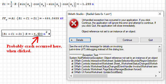

Even after a Clean Re-installation, crashes continued to occur on and off.
Attached sm file crashed when I was doing some changes to either default units,
or copying etc. (I'm not sure). Note where I clicked.
Radial Gate Ex 1.sm (194,77 КиБ) скачан 715 раз(а).

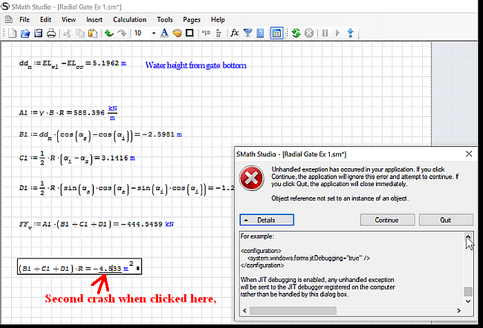

Second crash. BTW how do I create stack traces and copy?
Radial Gate Ex 1.sm (195,59 КиБ) скачан 737 раз(а).

Still not able to reproduce but at least we have an hint.
Simply copy the text from the error window
You can paste in the following BBcodes if it is too long
[spoiler]my text goes here[/spoiler]
or
[code=markup]my text goes here[/code]

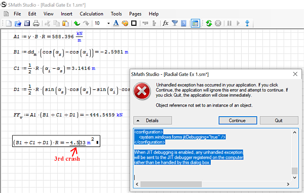

Thanks Davide.
Third crash occurred, and the stack traces (in MS Word) attached.
Radial Gate Ex 1.sm (195,59 КиБ) скачан 728 раз(а).
7067 3rd Crash-Stack Traces.docx (18,08 КиБ) скачан 423 раз(а).
