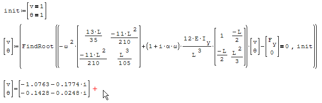

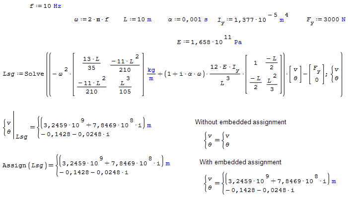

Besides correction of the unit mismatch, Solve seems to want the matrix equation in homogeneous form.
Matrix equation_Kr.sm (14,1 КиБ) скачан 1222 раз(а).

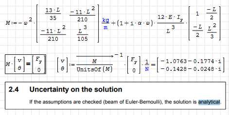

#9 Опубликовано: 13.06.2023 18:25:48
Hi. Another way.
