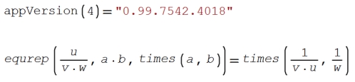

"equrep() function supports variables/functions replacements now."
Any example about what that means?
Also, I see that this error persists:
Any example about what that means ?
Can you show an application of it ?
An image is good enough.
Thanks ... Jean
Thanks ... Jean
Hi Jean. Here: Applications for equrep: expression isolation and laplace transform.

Just to make it clear: equrep() function is not something I'm spending time on to create/support/improve. This function appeared as a demo of the updated symbolic core of SMath Studio. This function is an interface to the new functionality. You can use it or not, but it demonstrates possibilities of the symbolic simplifications SMath Studio provides.
Unfortunately it has at least one issue which is hard to fix. I'm doing my best to remove a bug, but if it will be too hard maybe I will revert my changes and use stable (which is used in latest stable version of the application) symbolic core again.
So it is not about equrep() function it is about core of the program, its performance, possibilities, behaviors etc. If you are remember, all the calculations in SMath Studio goes through symbolic optimization, so it is pretty important.

Hi. Thanks! Very much!
Issue is fixed in the latest stable version I have just published. equrep() made less powerful, so it will leave an equation as is in cases where error is possible. Like your example.

#16 Опубликовано: 16.09.2020 18:43:50
I post that question because interpret that then equrep works replacing f by sin in this example: "equrep(3+f(x),f,sin)=3+f(x)" but now I see that the correct way is "equrep(3+f(x),f(a),sin(a))=3+sin(x)"
