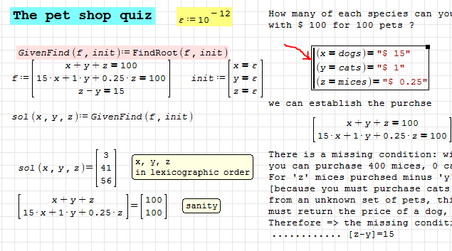

Solve GivenFind PetShop.sm (13,72 КиБ) скачан 1142 раз(а).

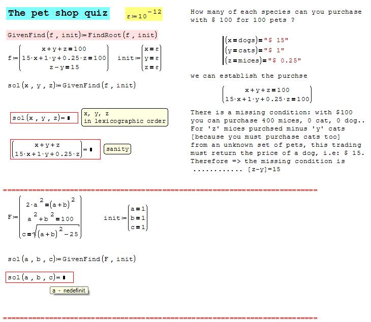

I tried before, including the way you suggest it. In addition I analyzed some examples I found on the forum. The results were the same. I attach a new image to one of the examples you gave me in your answer. You may notice a similar error. Therefore, please help me solve the problem.

Just suppress evaluation of the marked region.

The result is the same. I have not attached a new image. I specify that if I define the sizes x, y and z, the program returns the error "FindRoot - the function is undefined"

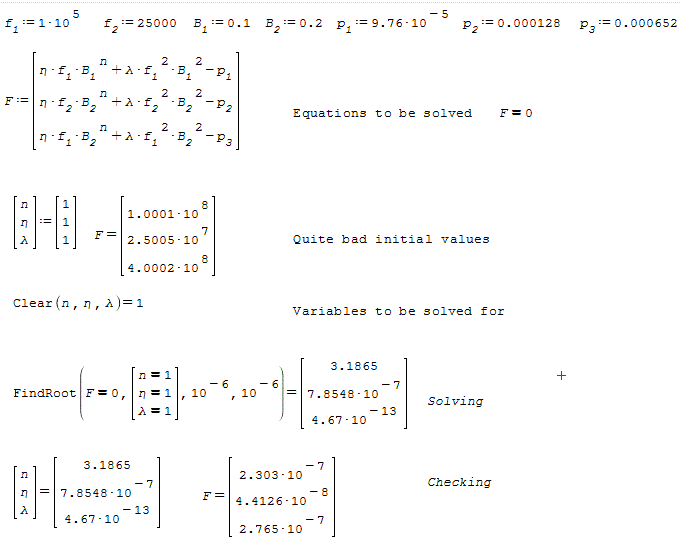

Greetings to all
Here is a practical and very laborious way to solve the initial problem. The three basic non-linear equations are those on a yellow background. The MathCAD program's symbolic calculation facilities were used to solve two of the basic equations in relation to the η and λ variables. The necessary substitutions were made in the third equation and I was able to define the function N (n) in this way. The equation N (n) = 0 is solved using the "solve" function in Smath. A second function (Λ (λ)) was then elaborated which was solved in turn using the same function. Finally, one of the two equations solved in relation to the variables η and λ is actually calculated. The whole calculation process lasted about 60 minutes. I wonder how long it would take if I did not have the facilities of MathCAD's symbolic calculation ?! Probably a lot of hours. What would have happened if (as Radovan had said) the number of variables would have been greater than 3 ?! It would have been frustrating indeed. Therefore, if Smath developers read this post, I think it would be good to consider the possibility of implementing a "Given-Find" and / or "Given-Minerr" computation procedures similar to those used in MathCAD. I attached here along with the image of the Smath solution, a picture of solving the same problem in MathCAD by using the "Given-Find" procedure. It lasted only as long as it was necessary to edit the necessary relationships in that spreadsheet. Otherwise, all the best.

It seems that for your problem there is a solution (do not know if it is a viable one). FindRoot() will do the job here. One might consider FindRoot() similar to Given/Find in Mathcad.
FindRoot3.sm (13,61 КиБ) скачан 1088 раз(а).

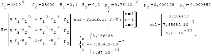

Here's the Smath file. The other was an image file.
FindRoot.sm (8,94 КиБ) скачан 1117 раз(а).

This is a matter of third and fourth parameter of FindRoot() function (numerical precision). The solution will be different if you change them. Just look at the order of magnitude of the solutions. The second and third values are quite close to zero. Therefore, one might expect this behavior.
