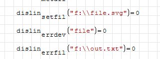

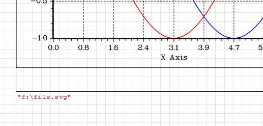

Hello Franco,
In my notebook I've not unlocked the privileges for "C:\" so the file crashes, but using another path where I have the privileges you have to use simply that path (standard, without double backslashes).

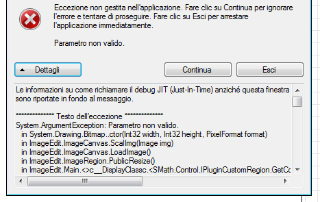

BTW I can't resize the image from the context menu of the Image region, an hard crash occours
ioan92 25.02.2016 12:49:00
#23 Опубликовано: 25.02.2016 13:08:02
Alexander O. Melnik
Alexander O. Melnik
Please report any Image Region bugs to the plugin thread (together with offending file) - I will definitely investigate this.
I have quickly checked "reset size" on a variety of .svg (both embedded and linked) and they work well

Davide,
I have tried to enter a normal path without succeeding probably I am a beginner and I am not able to enter a simple path in a placeholder too.
So not being able to do this I tried the brutal approach of the copy and paste of the path from the first DSLIN instruction and it is with a double quote ..and it worked fine ; probably it is a feature of the image plug-in that is undocumented.
Then I started to play with the image turning it and was OK than I probably played with the size handle and had your same issue .
To make other testing I was forced to reload the file from the UNI e-mail and restart from scratch.
Franco

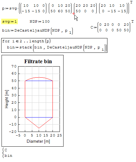

I'm just instrumenting a filtrate bin, rough work.

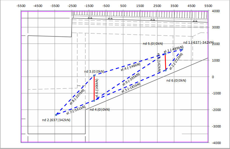

Alexander O. Melnik
Alexander O. Melnik
As usual, a picture is worth a hudred words... This is what I would like to get at the end (excluding background graphics), without using EXCEL of course. Each node and line is a separate function.
