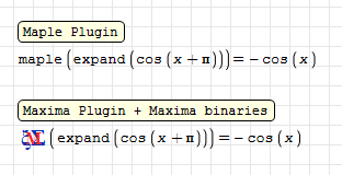

Maxima plugin cannot be used under linux, yet. I couldn't make it work as it is.
I had to open my windows pc to show you expand command with maxima plugin.
