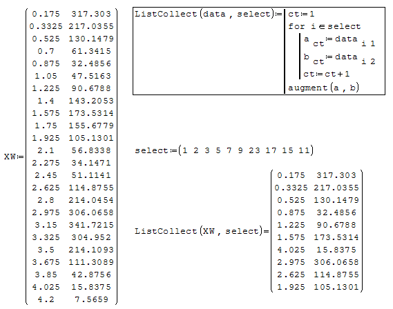

#4 Опубликовано: 28.03.2016 17:42:27
The data table can be any size, search any rows/any col.
Just modify/adapt to your project.
