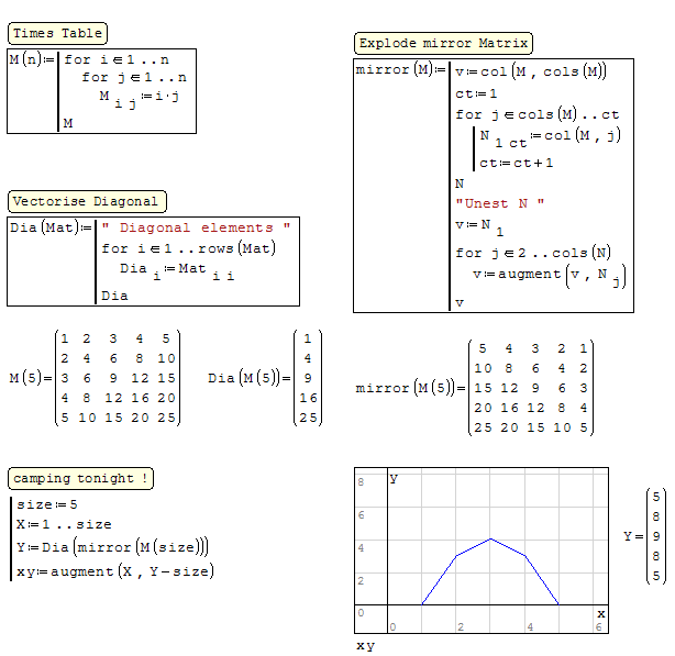

How could I get a vector from a diagonal?

Something like this? diag2vec()

WroteHow could I get a vector from a diagonal?
Like this ?
Utilities Matrix [Times, Dia, Mirror,Euclid].sm (39,12 КиБ) скачан 1080 раз(а).

WroteWroteHow could I get a vector from a diagonal?
Like this ?
