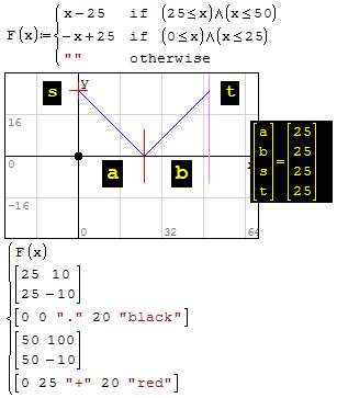

Oh ! ... your proposal is not much productive, is it ?
The picture is strictly discontinuous.
Reflection.sm (54,37 КиБ) скачан 1093 раз(а).

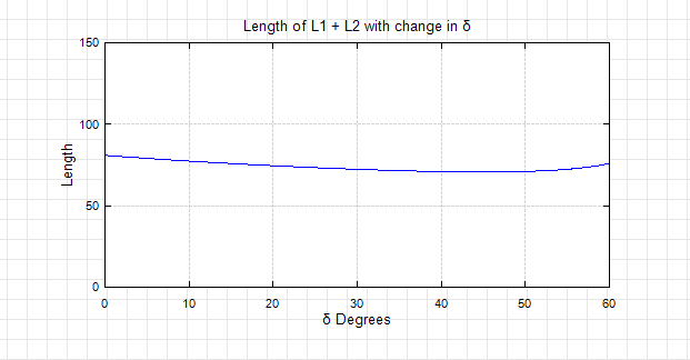

I don't think L is discontinuous for ddegrees in the range 0 to 60.
What am I missing here ?
L(ddegrees) should vary smoothly from L(0) to L(60)

You are missing to plot the literal demo diagram,
here is as per your inputs [a,b,s,t].
More is missing from incomplete project description.
Reflection [abst].sm (62,14 КиБ) скачан 840 раз(а).
WroteYou are missing to plot the literal demo diagram,
Refreshed from your literal inputs.
You may have to revisit your College Physics book.
Cheers ... Don't hesitate.
Reflection [abst].sm (128,95 КиБ) скачан 839 раз(а).
WroteI don't think L is discontinuous for ddegrees in the range 0 to 60.
Yes the length L is continuous with respect to ddegrees. I think Jean misunderstands the question. See attached. (A little sloppy but it works)
Edit: Updated graph to add labels
Edit2: Had an error in definition of L. Fixed.
Reflection_alyles.sm (177,77 КиБ) скачан 1105 раз(а).

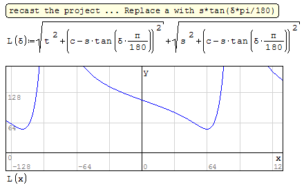

WroteI think Jean misunderstands the question.
Quite right: misunderstood the travelling distance vs °incidence.
Thanks, interesting project. We need more real projects.
Reflection [abst, alyles].sm (186,64 КиБ) скачан 883 раз(а).
... You can have it to a good degree of accuracy
as a continuous function, though a bit strange.
Reflection [abst, alyles].sm (252,97 КиБ) скачан 867 раз(а).
Wrote... You can have it to a good degree of accuracy
FYI Jean you're using one of my earlier files where I had a copy paste error in the derivation of L(d), the second root term should only have s*tan(d*pi/180). You can get rid of the "c-"
WroteFYI Jean you're using one of my earlier files where I had a copy paste error in the derivation of L(d), the second root term should only have s*tan(d*pi/180). You can get rid of the "c-"
Thanks ... updated.
