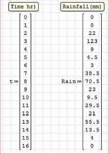

It will be much appreciated if somebody can show me how to draw a bar graph in X-Y Plot or ZedGraph,
using two vectors as shown please ("t" in x axis, "Rain" in y axis).

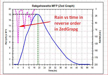

#6 Опубликовано: 07.11.2016 23:13:50
NDTM Amarasekera
NDTM Amarasekera
Thank you again Davide and Radovan.
To demonstrate a Flood Hydrograph, it was only possible to draw a line graph (in reverse order) in ZedGraph.
In X-Y Plot reverse order is not possible.
Radovan Omorjan 08.11.2016 03:42:00

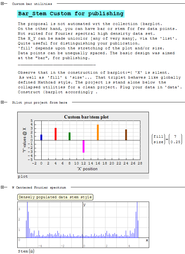

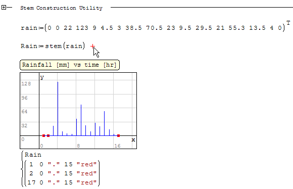

#7 Опубликовано: 08.11.2016 00:23:45
I know nothing about "Zedgraph".
I can se Davide had a "cat in the hat".
Stem plot does same/different in no time
except for the red 0 rain [<20 sec]
Cheers, Jean
Forum Rainfall.sm (87,7 КиБ) скачан 1252 раз(а).
Davide Carpi 08.11.2016 06:03:00, Radovan Omorjan 08.11.2016 03:42:00
#8 Опубликовано: 08.11.2016 02:47:45
This scrap proposal makes me happy for some
distinctive small project. Manual but convenient
for small projects. For larger size and unicolor
the project needs be constructed around a counter.
Radovan Omorjan 08.11.2016 03:42:00, Davide Carpi 08.11.2016 06:03:00

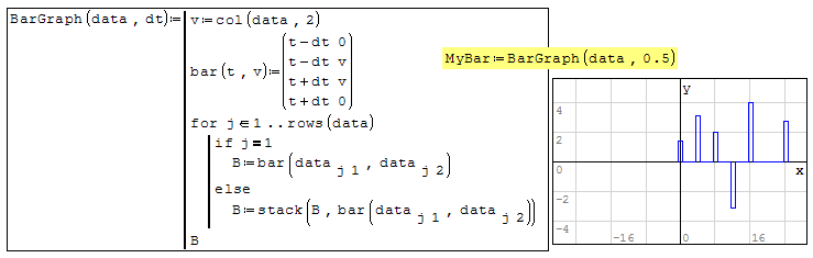

#9 Опубликовано: 08.11.2016 03:02:22
... next version
frapuano 08.11.2016 05:02:00, Radovan Omorjan 08.11.2016 03:42:00, Davide Carpi 08.11.2016 06:03:00, NDTM Amarasekera 08.11.2016 06:40:00

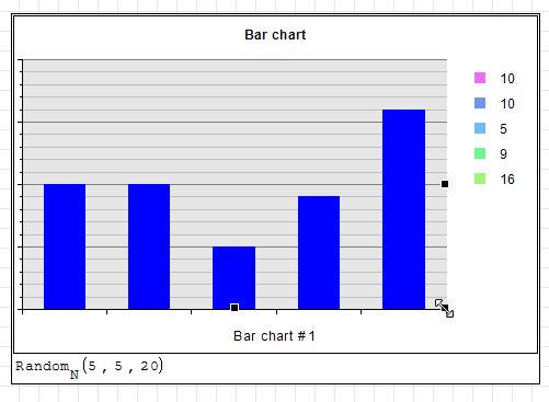

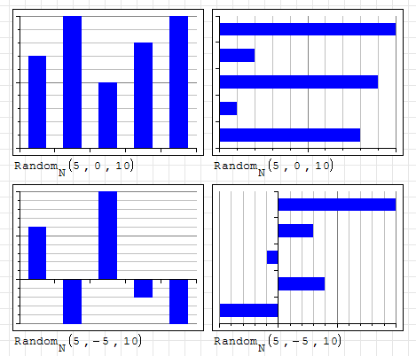

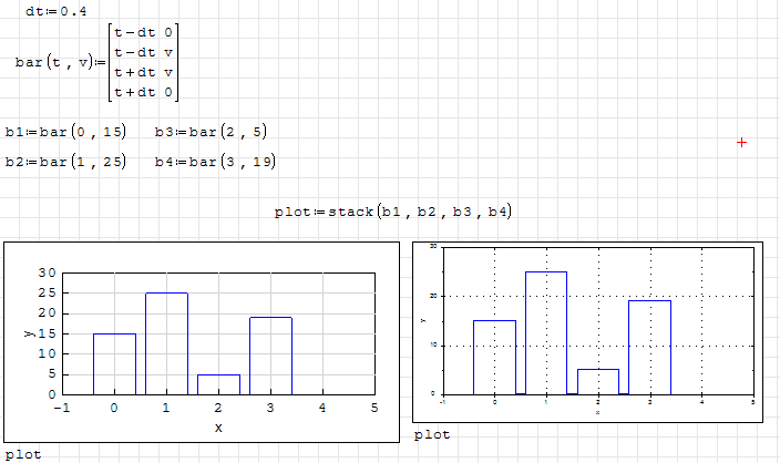

#11 Опубликовано: 08.11.2016 07:12:41
Simple example
Radovan Omorjan 08.11.2016 07:29:00, frapuano 08.11.2016 08:06:00
#12 Опубликовано: 08.11.2016 08:13:06
NDTM Amarasekera
NDTM Amarasekera
Many thanks to Uni, for the simple example.
I was expecting a response from you also.

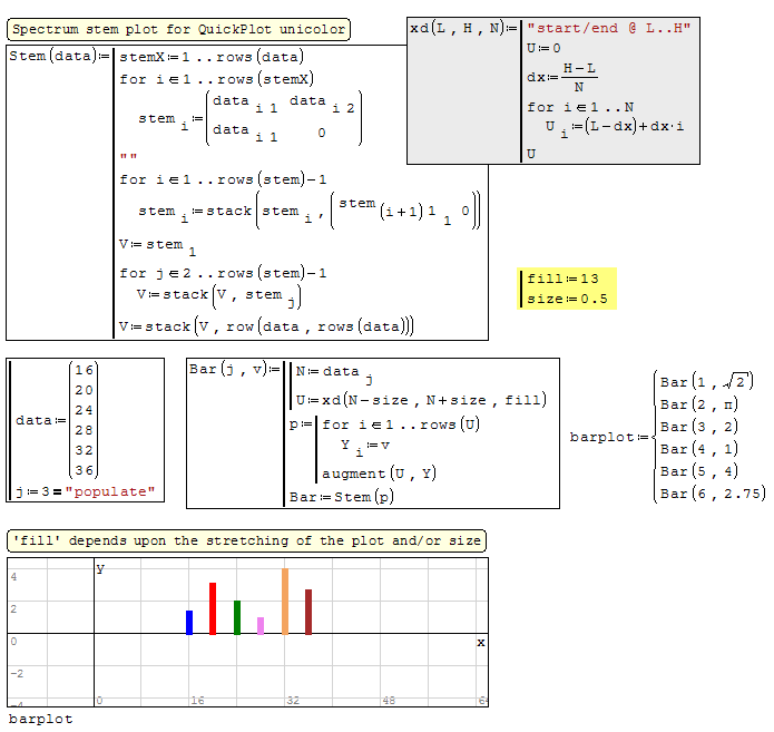

#13 Опубликовано: 08.11.2016 10:38:56
#14 Опубликовано: 08.11.2016 11:07:35
In the Viacheslav proposal, you don't see bar not plotting equally wide.
Because the bars are so wide ! In the real project I proposed, the bars
are much thiner for dense project. Thus there will always be at least
"one" bar looking thiner because of the plot pixel impossible to match
perfectly along the stretching of the plot.
Cheers, Jean
#15 Опубликовано: 09.11.2016 07:26:03
NDTM Amarasekera
NDTM Amarasekera
Simple example
I used method proposed by Uni to plot Bar Graph to show rainfall in ZedGraph as shown (in reverse order).

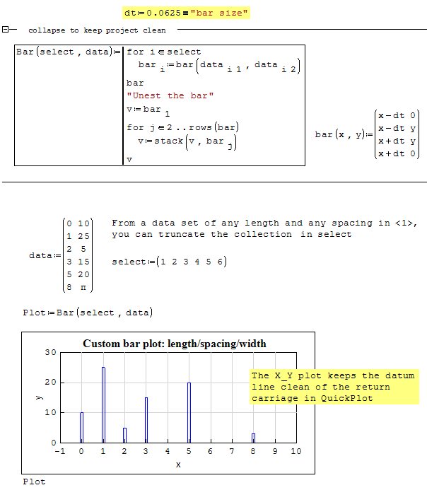

#16 Опубликовано: 09.11.2016 11:54:21
Thanks for the "Zed Graph" snippet. I don't have this plugin
whereas I will stay Smath 5346, and don't intend to upgrade.
The attached document is for publising projects.
Cheers, Jean
2D Bar Plot Custom.sm (35,01 КиБ) скачан 1234 раз(а).
