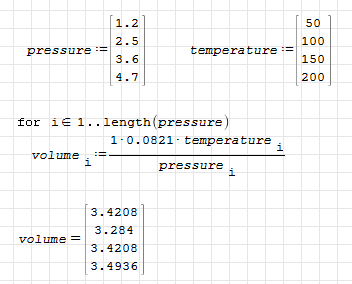

Could you tell me if their is any way to loop through a list the Way mathcad does with the I:=0..n, as a "global" methode (not inside a formula).
Below a screenshot of the case
Image explicative
Thank you for your help

#6 Опубликовано: 16.11.2017 15:01:37
1 436 сообщений из 2 916 понравились пользователям.
Here you have:

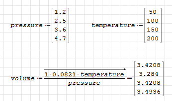

The arrow over the math is the function vectorize(), and that's what you need to apply the elements of the ranges avoiding loops (that is the other way to accomplish the task)

#7 Опубликовано: 16.11.2017 15:14:25
pierre
pierre
2 сообщений из 17 понравились пользователям.
Thanks a lot for the explanation!
You made my day!
