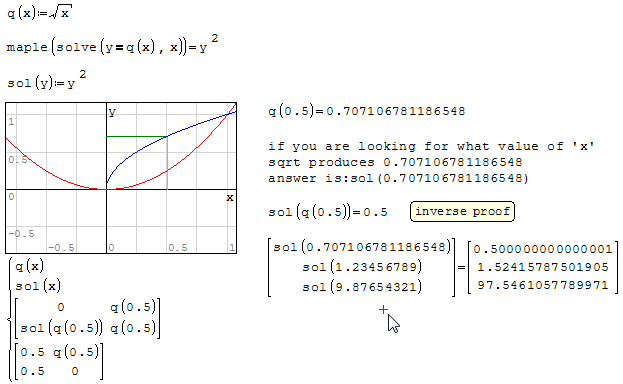

#2 Опубликовано: 22.09.2019 13:25:49
I have a function (for example y = sqrt(x)).
I want to solve it for specific values of x between x
You don't have to solve between limits,
whereas you are solving generally.
No problem to constrain the plot [not shown].
Your question is ill posed, as I can figure.
Solve Inverse Symbolic Suite.sm (93,85 КиБ) скачан 682 раз(а).

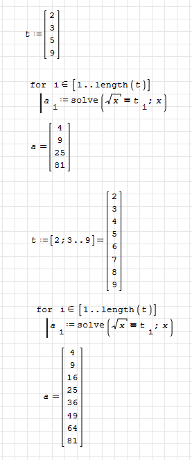

#3 Опубликовано: 22.09.2019 15:10:00
585 сообщений из 1 355 понравились пользователям.
I have an equation (for example y = sqrt(x)).
I want to solve it for specific values of x between x>=a and x<=b
I would print out each resulting y.
case 1: in steps of delta x = delx
case 2: the input values of x are not in equal increments ?
are you looking for something like this?
you can use matrices or vectors and loops.
don't forget to change your roots range in the tools>options>calculation menu.

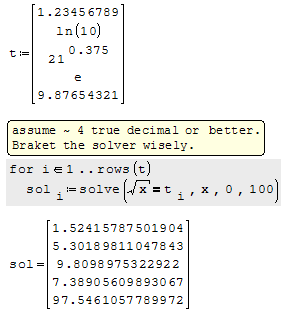

#4 Опубликовано: 22.09.2019 15:52:07
Harry Mangurian 22.09.2019 18:08:00
#5 Опубликовано: 22.09.2019 15:56:52
Solve SQRT(x).sm (9,19 КиБ) скачан 724 раз(а).
