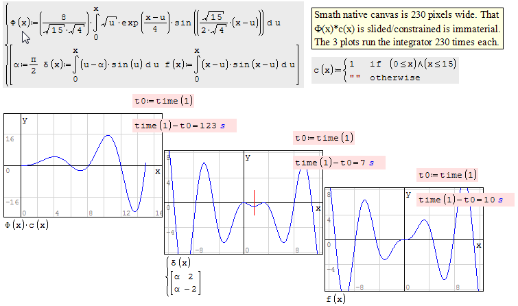

By comparing Φ(x) and f(x) we notice Φ(x) contains 3 numerical approximations.
Therefore, we know in advance Φ(x) will take < 3^2 times f(x) + few more
arithmetic operations ... roughly: Φ(x) will take < 100 sec.
Leave the integrator accuracy 100.
Maths Dirac Integral.sm (11 КиБ) скачан 68 раз(а).
#2 Опубликовано: 31.08.2017 11:13:21
... [suite], you can replace the two constant terms by their
decimal evaluation. It will drop the timing nearly by ½.
It will not significantly change the the integration due
to the integrator not so accurate !
