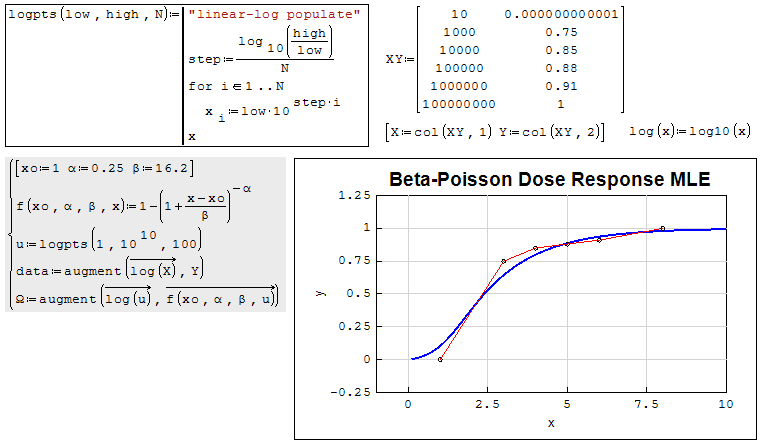

... else than Bode.
Utilities logpts [Beta_Poisson].sm (9,4 КиБ) скачан 994 раз(а).
#2 Опубликовано: 03.12.2019 12:21:29
... else than Bode.
... more USER
Utilities logpts [Beta_Poisson].sm (13,52 КиБ) скачан 985 раз(а).

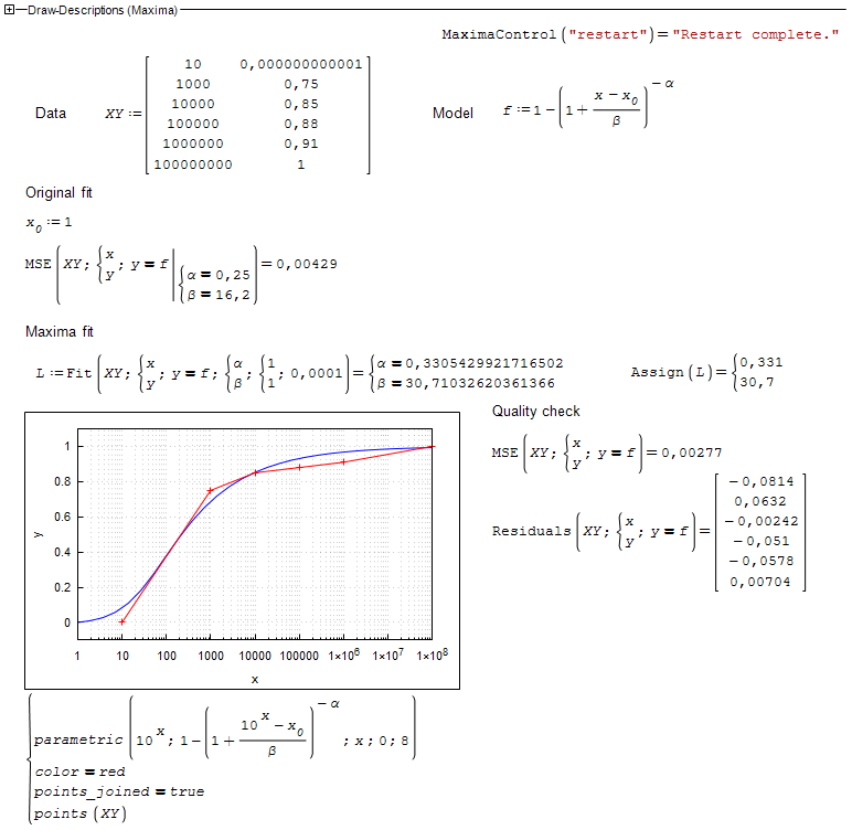

Here is a Maxima version, including the fit procedure. Note the use of parametric() in order to get evenly distributed points in the log plot.
logplot.sm (145,83 КиБ) скачан 1264 раз(а).

#4 Опубликовано: 03.12.2019 22:19:59
Thanks Martin.
1. added the source experiment notes
2. added Weibull MLE example.
Utilities logpts [Beta_Poisson].sm (353,86 КиБ) скачан 1116 раз(а).
