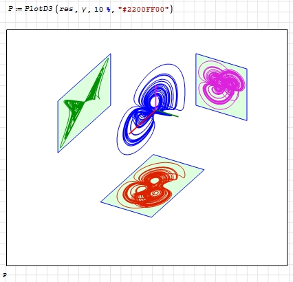

Hi. For show the four plots at once.
DadrasAttractor.sm (46,22 КиБ) скачан 1053 раз(а).
Fridel Selitsky 27.07.2021 03:46:00

Thanks for the 3D image

How to get explict parametric function, like x=x(t), y=y(t), z=z(t) from above equations?
Now it is possible.
Dadras Attractor.sm (20,15 КиБ) скачан 1048 раз(а).
The Aizawa Attractor.sm (21,51 КиБ) скачан 1034 раз(а).
Click to enlarge Click to enlarge
