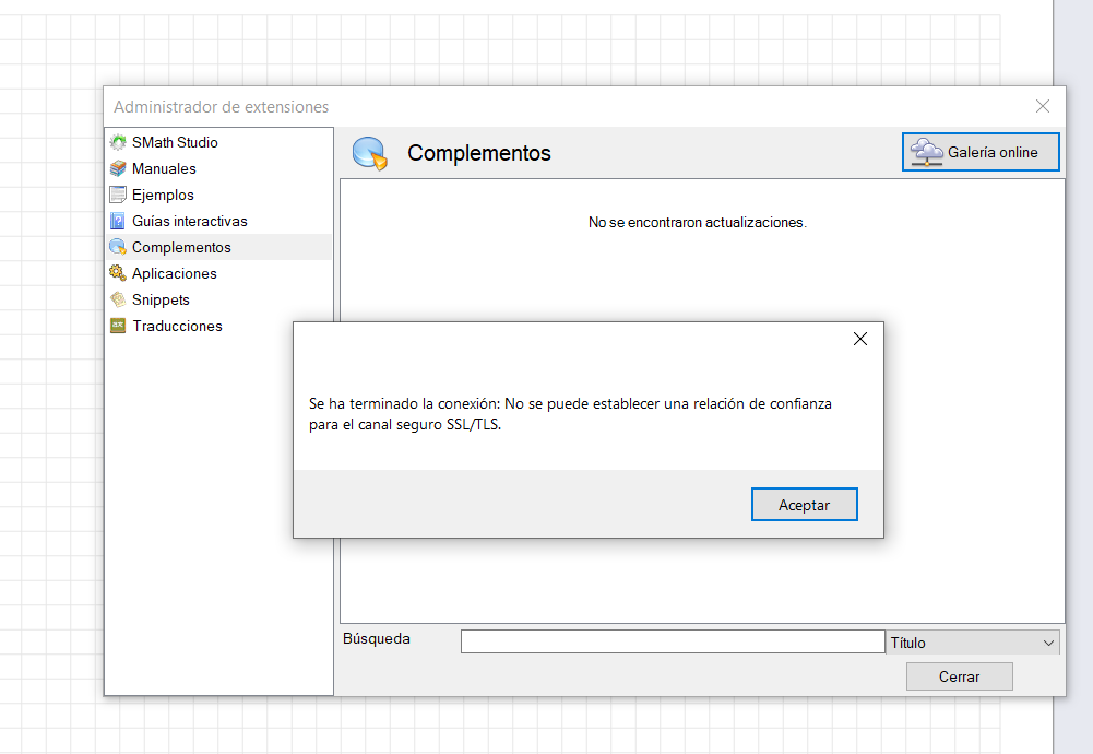

Hi there, I newbie on this software, I wanna to download plugins, but that don't loads.
I hope that, can help me, because this program is awersome.
The message is : Connection terminated: Cannot establish trust relationship for SSl / TLS secure channel.
I left a screenshot.

I have the same problem. Few days ago everything was fine

this could be related to certificates of the smath website not valid any more, I had issues with opening the forum site and had to confirm an unsecure connection. I think the same happens in the background when the app is connecting to the server.
It was, should be solved now.

I am behind a firewall with "ssl inspection". zip download is by default not allowed.
I think in my case this causes the same error message.
So I have to tell our admin to allow this connection.
Can anyone tell me the adress, which needs to be allowed?
