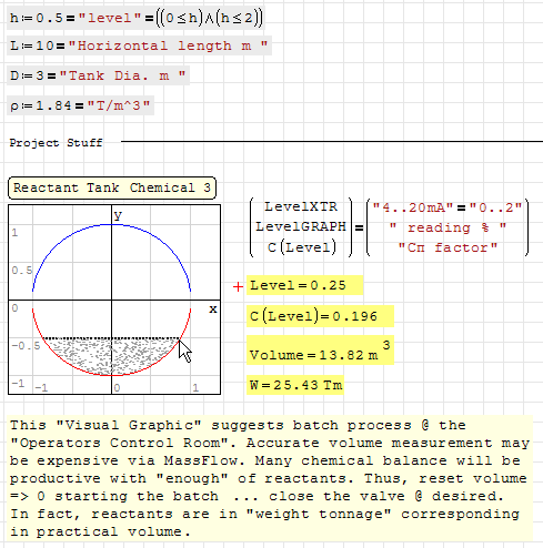

Previous attachment deleted for update.
Play with (0≤h)&(h≤2) and become an "Educated Operator"
in ½ hour bed time reading. I pest off: NO % Unit !
The complete stuff can be found in "Samples Instrumentation"
Cheers, Jean
