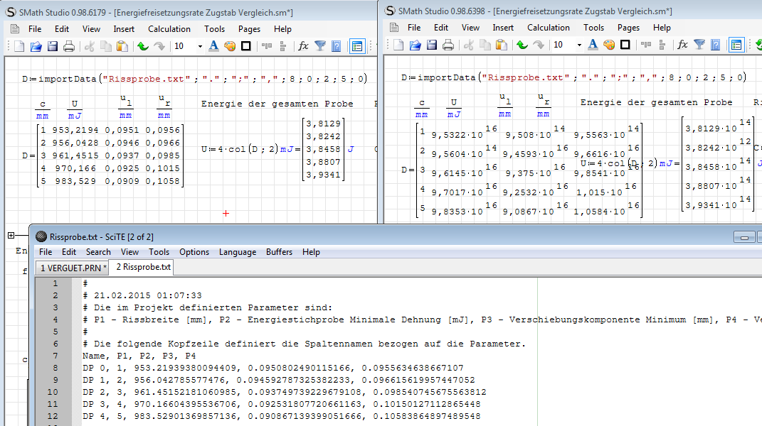

There is a regression in importData. The attached file can't be read correctly. It seems that the decimal separator is ignored at all, no matter to what value it is set.
Rissprobe.txt (695 Б) скачан 1183 раз(а).
Confirmed, thank you.
