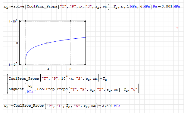

Take care :
Your CoolProp function, as you write it, does not change the sign, between the two limits of the variable p :

#6 Опубликовано: 03.06.2024 02:12:41
Hi. The guess values, in this case the range, are part of the solution, this means that you must know where the numerical procedure works fine. In this case the interval 1 MPa ... 6 MPa.
3-2-CoolProp-Solve.sm (49,75 КиБ) скачан 1524 раз(а).
