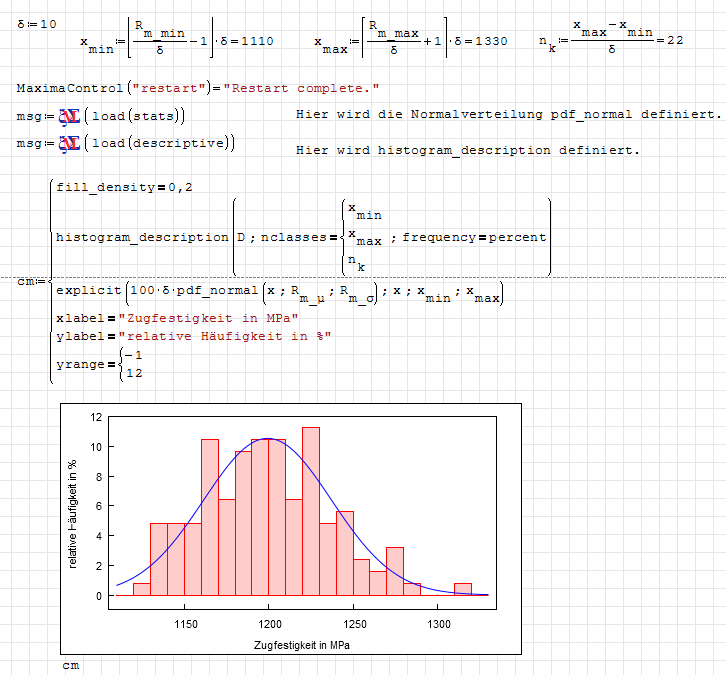

Here is an example adapted from a book on materials science with mathcad, using the maxima plugin and loading additional maxima packages.
Streuung.zip (20,91 КиБ) скачан 430 раз(а).
